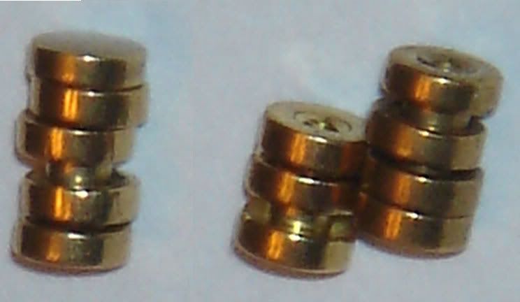

found these in a dusty old dom ix kit, in my mind i call them abacus pins, the inner discs move side to side and up and down.
i haven't really gotten around to testing them too well but it's a pretty neat driver pin.

All of the round sections move independently? Sounds like a chalenge to me. When you got the false set the shape would change and it looks like they could become unset again. Be interested to see what effect they have on picking. Anyone know of a lock with these in?

Postby Tempature » 3 Jun 2007 12:53
thats krazy :)
its like an insane version of serrated pins. ya, picking a lock with those would be quite a challenge i assume

Postby mh » 3 Jun 2007 14:52
Cool, thanks for sharing!
But I thought DOM ix pins always had that strange shape to make sure they don't turn inside their chambers?

Postby JackNco » 3 Jun 2007 15:08
ooooh they look fun. i wounder if you could retrofit them in a normal lock? Do DOM use standard sized pins?

Postby Eyes_Only » 3 Jun 2007 15:11
Trippy. Looks like a crankshaft from an engine.
Postby linty » 3 Jun 2007 15:16
i also am sort of confused as to why they are round as well, I've seen the square corner dom ix pins elsewhere, but this is from a pinning kit which is clearly marked, just something my shop hasn't supported in years.

Postby raimundo » 3 Jun 2007 16:51
they are drivers/toppins, so they would not need the corner to keep from rotating, that is only necessary on the bottom pin because the shear line is not top dead center, but off set. this means that one side of the pin is higher than the other at opening. without it, the shear line would be sloppy or impossible.

Postby JackNco » 3 Jun 2007 16:59
thinking about it again im not sure if it woudl be much harder than a spool pin. i mean you wont feel the discs sliding about so it would act much the same as a spool pin.

Postby Raccoon » 3 Jun 2007 17:24
Unlike a spool pin, this pin would still have spring tension to it when it is false set.

Postby Schuyler » 3 Jun 2007 22:44
i pulled a couple of these out of a dom a LONG time ago, never put it back together.
mine was not a ix
Postby Kaellman » 4 Jun 2007 3:51
Iv seen these in a DOM before. Cant remember where or when, but they sure look tasty!

Postby linty » 4 Jun 2007 15:54
The pins belong in a dom ix ht, which uses the same weird-shaped bottom pins that can't rotate.
they are about .116" diameter, while a standard lab pin measured .113", so while they are just a hair wider, they fit fine in a regular LSDA lock.
