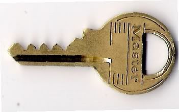

Postby tmaxx258 » 25 Jul 2007 11:27
So what do you think?Image

Why the heck did you do this thread? THere is already millions of bump-this-bump-that threads, where this would go. Your bump key is not good. Why? If you had searched, you would have seen a photograph/scan from the same key.
Sorry if this sounds so outrageous, it is just that there is every second day a bump thread.

Postby tmaxx258 » 25 Jul 2007 11:54
Sorry, i was just excited that i made my first bump key with little knowladge of how to make them

Postby nekret » 25 Jul 2007 11:54
It's hard to tell without a scale for your key but the valleys look too narrow and you might have some problems bumping anything with low set pins.

Postby Jaakko » 25 Jul 2007 12:02
tmaxx258 wrote:Sorry, i was just excited that i made my first bump key with little knowladge of how to make them :oops:
Well, does it work?
I'd say that the valleys are too narrow and/or the peaks too big, as previously mentioned.

Postby tmaxx258 » 25 Jul 2007 12:07
Yeah it works ,it opens master#1,#3,it just takes some getting use to

Postby freakparade3 » 25 Jul 2007 12:35
For a first attempt and getting a working key is great. Good job. If you file a bit off the tip and the shoulder it will work even better.

Postby tmaxx258 » 25 Jul 2007 12:39
freakparade3 wrote: If you file a bit off the tip and the shoulder it will work even better.
Thanks I'll try that

Postby Shrub » 25 Jul 2007 12:47
Try and have a look for the link to download zekes pdf on making them,
Its one of the best ive seen where the user has no clue before hand and has never done such a thing, good effort,
