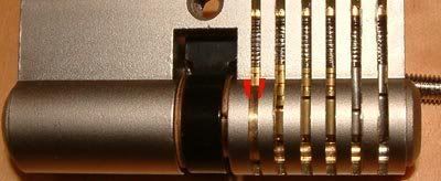

I think I may have seen this idea in another thread, is this idea which you are thinking of? Image
(cutaway from toool.nl). I can see that the pins may not align properly when the key is inserted and may catch on the underside of the sheer line. Also I think that the keyway will simply turn 5degrees, (to the edge of the bevel and then the edge of the cut will act as the ledge which it will then bind on (the left hand red section in picture), in effect simply making tolerences far worse. In practice neither may happen but something to think about.

squelchys right
Postby raimundo » 11 Aug 2007 8:24
squelchtones right, its about making the step on the lip of the plug holes slippery, but in the photo, the OP shows what appear to be bottom pins with beveled edges at the shear,
I think if he pins a lock this way and trys picking it with greater tension he may find that it actually is pickable.
but I leave it to him to do the experiment.
Yale had some bottome pins that were pointed on both ends, they were not hard to pick.
