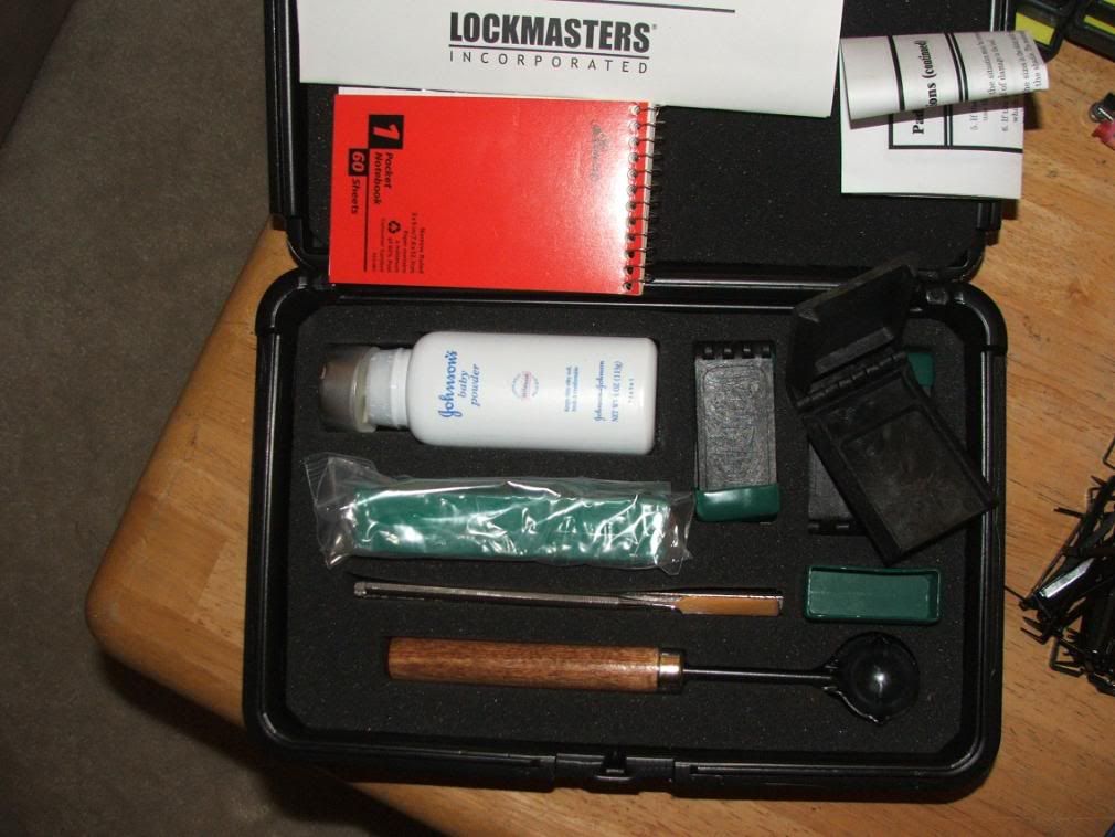

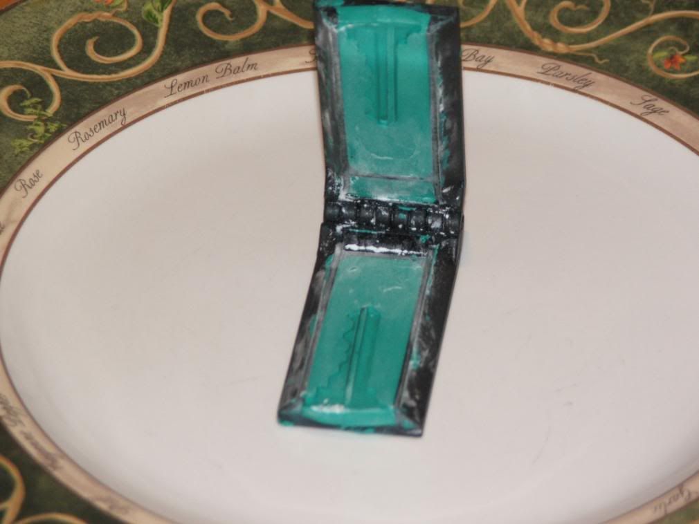

Alright, lets make a key! First, we need a sweet new kit from Lockmasters called THE CLAM ($150). This is the Deluxe Clam. It comes with a whole bunch of stuff you don't need. But being that it was purchased by the Longhorn Lockpicking Club, we decided to buy the best.

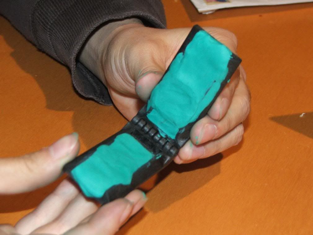

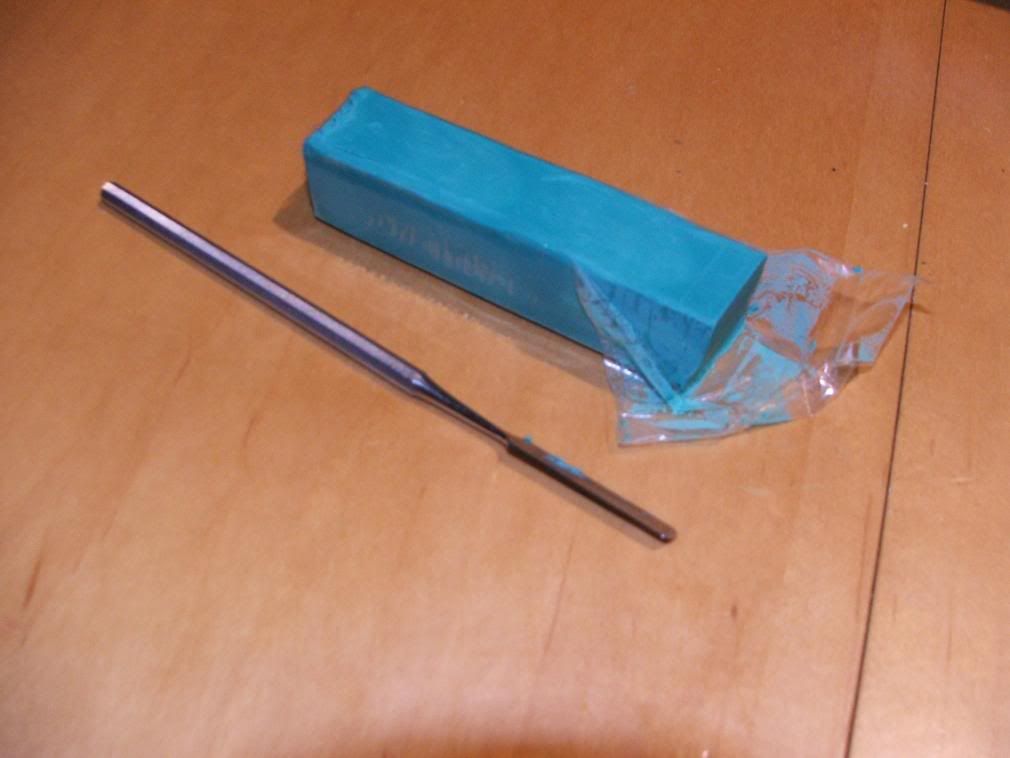

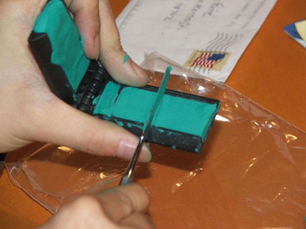

Next cut an in inch of clay from the clay block.
Put it in the key mold.
Mash it down.
Smooth it out.

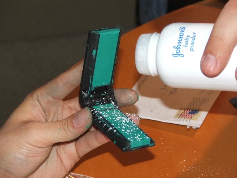

Baby powder.

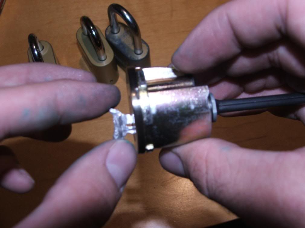

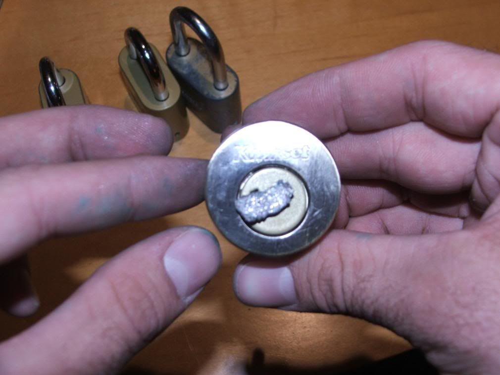

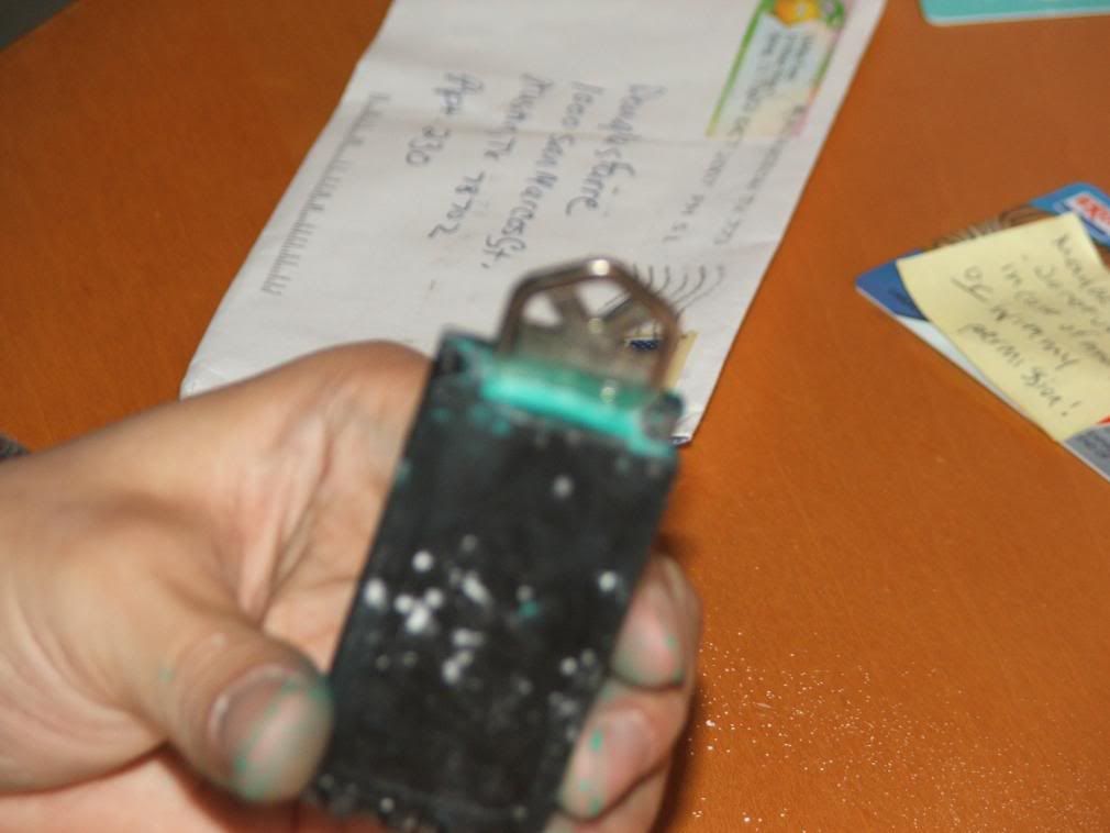

Stick in the key. and PRESS

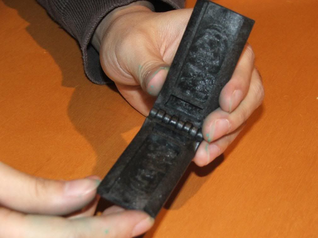

Look at the mold.
This is what i used to do before rehab :(

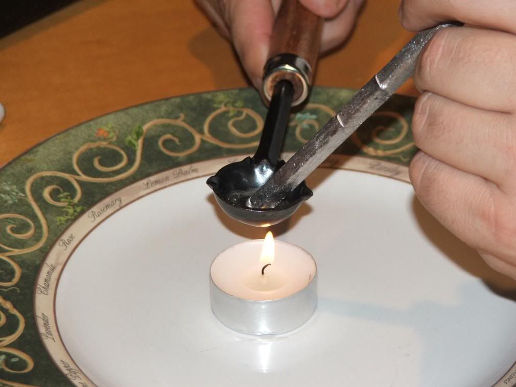

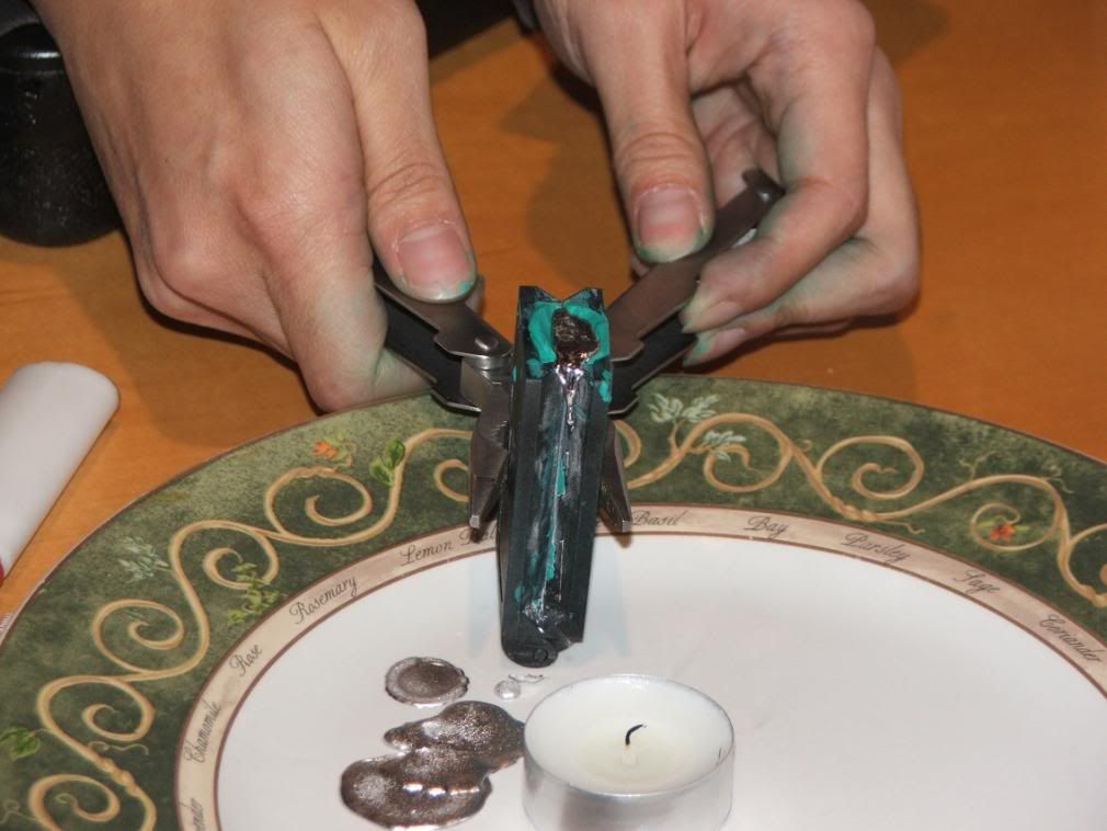

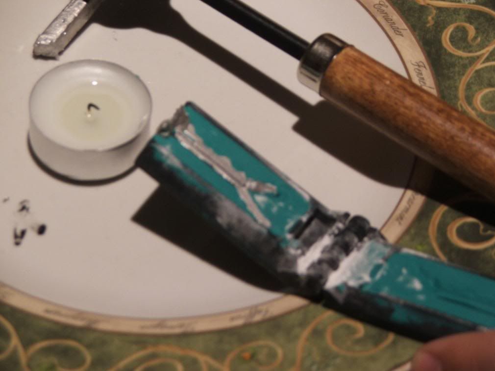

Poor in the mold.
AWESOME>
Key

Postby MacGyver101 » 24 Oct 2007 23:07
Interesting... thanks for the pics!
One question: what's the extra cut-out near the hinge for (other than eating plasticine)?

Postby dougfarre » 24 Oct 2007 23:16
MacGyver101 wrote:Interesting... thanks for the pics!
Good Question! You can use that extra cutout near the hinge to make a replica of the profile of the key. That way you can determine which key blank is required. You can search through the ILCO World Key Blank Encyclopedia.

Postby josh0094 » 24 Oct 2007 23:41
what kind of metal is that. looked like tin... maybe even lead... or solder? i was thinking about trying to do somthing like that with my key.

josh0094 wrote:what kind of metal is that. looked like tin... maybe even lead... or solder? i was thinking about trying to do somthing like that with my key.
I was thinking it was some kind of nickel alloy, but i could be wrong.

Postby MacGyver101 » 25 Oct 2007 0:29
It's likely either Wood's metal or Field's metal. They both melt at fairly low temperatures, and are pretty common for quick casting/modeling exercises.

Postby Johnny P » 25 Oct 2007 2:39
It's woods metal - approimately 23 to 25 percent lead content. Very soft metal and not suggested to be used as a permanent key as it can easily break or get stuck in the lock from bending.
