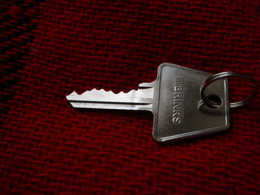

I've picked it almost 13 times so far. It takes me 5-6 min to get it to open. This particular lock is odd, the pins set from front to back (front being the closest to you), so after getting a false set, I single pin pick it from front to back. I can do it pretty consistently. If the key (and in turn the pins) had a more jagged set up it would be harder to get, they have somewhat of a progression to them.
hmm... a picture is worth a thousand words here.. here's a picture of the key.
http://i179.photobucket.com/albums/w285 ... C00052.jpg

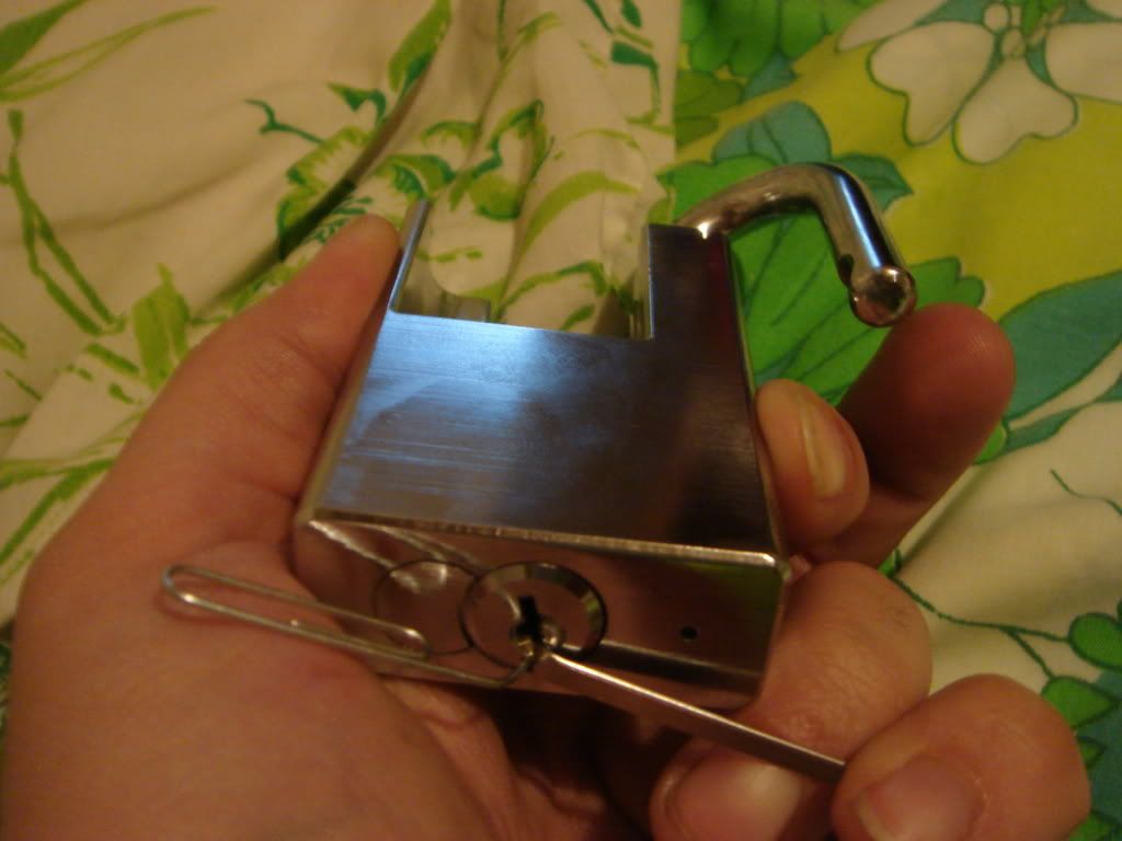

And here's when I picked it for the very first time (^___^)
http://i179.photobucket.com/albums/w285 ... C00049.jpg

Postby FFVison » 27 Nov 2007 13:13
Holy cannoli!!! You picked that with a paper clip? Wow! Congrats. I have one of these and I haven't been able to pick it with proper picks. I have 2 other Brinks padlocks, one is a gate lock as it says on the packaging. It's a laminated lock about the size and weight of the Master #5. I have picked that fairly easily at first, though it has gotten a lot harder as of late, though I can still occasionally do it. My other Brinks lock is an R70 which is pretty easy for me. But my shrouded is one of the ones I have that I haven't gotten yet. I have probably too many right now that fall in that category, but the ones I can get sometimes seem inconsistent. So yeah, keep working on that shrouded lock, and good luck.

Postby Puzzlebox » 27 Nov 2007 13:21
The paper clip was used to stop the tension wrench from catching on the side wall... I got the idea from watching a youtube video of someone doing it with two tension wrenches. I actually picked it with a small diamond pick from the JPXS-6F from southord.

Postby jgor » 27 Nov 2007 13:30
Puzzlebox wrote:The paper clip was used to stop the tension wrench from catching on the side wall... I got the idea from watching a youtube video of someone doing it with two tension wrenches.
Wow, I can't believe I didn't think of that sooner! That's an awesome idea, at least 3 locks I have come to mind that would be so much easier using the two tension wrenches or a paperclip in between, i'd just never seen that before. Up until now i've been balancing the tension tool between the wards, or using an oversized tension tool that would reach high enough that it wouldn't slip. Needless to say both methods were inconvenient. Thanks, and great job with picking the lock multiple times!

Postby Gordon Airporte » 27 Nov 2007 22:45
It took me forever to get mine the first time - what a great feeling.
The paperclip idea is good, but I use a wrench with a very short stub of a blade and tension from the other end of the keyway.
