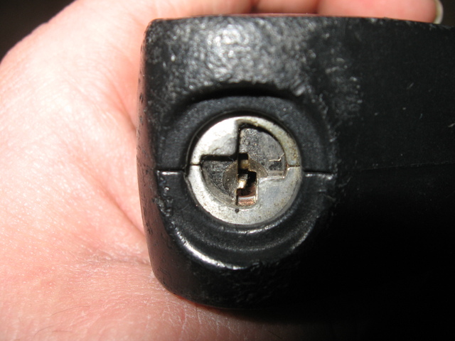

Postby zikmik » 3 Mar 2008 8:01
Master Lock 8418KADCAMO-TMB Python Camo Adjustable Cable Treestand Lock
Coast from $12 to $25
From this picure key doesn`t look impressive and hard to pick

Postby ax0n » 5 Mar 2008 17:00
dougfarre wrote:The latest in shimming! Awesome. Could you take a picture of the keyway?
I'll get to it tonight.
The cylinder isn't hard to pick, but it's a very, very thin keyway and the turning tension is out of this world. The cylinder, when rotated, pushes two spring-loaded jaws away from the cable. The spring-loaded jaws make the key very hard to turn. Combined with the tiny keyway, it's hard to get a tension wrench that's beefy enough to turn the cylinder but small enough to give you working room.

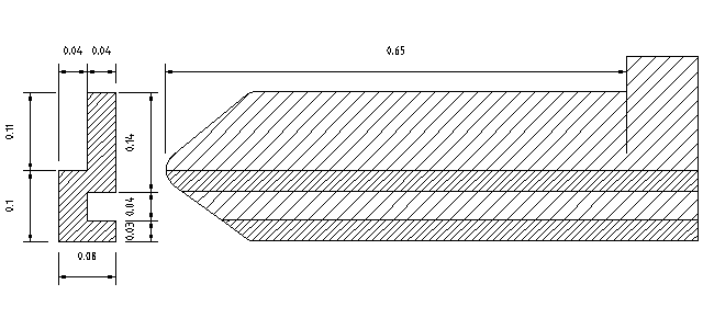

Postby ax0n » 5 Mar 2008 21:32
Also, I took my calipers to the key. Here are the dims:

Postby zikmik » 6 Mar 2008 1:58
These picture put new light on topic, I recall my comment... :)
