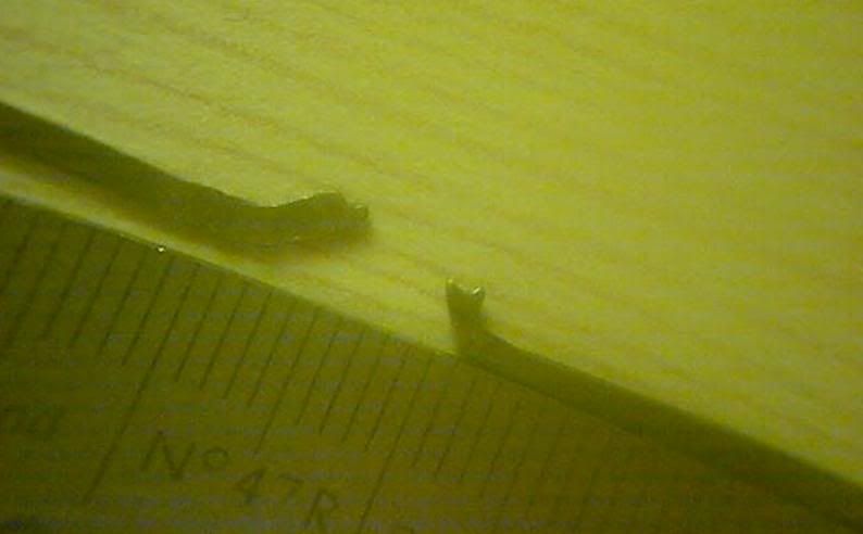

I would like to share with you all a method of finding, and more importantly keeping the pick on a pin without slipping (how many times have you slliped and had to start agian?), that you are trying to pick in a pin and tumbler.
I have found that if a small depression is made in the end of a hook pick (my prefered pick) it will stay on the end of a pin with less slipping. The images below show 2 of my picks a large and a smaller hook with such depresions.
I use the larger one for bigger padlocks. I find the smaller pick on the right is also great for restricted keyways as rather than lifting (or pushing) pins, I can twist the pick to follow the keyway which gives the same effect. The depressions make it possible for the pick to stay on the pin required.
The depressions also help when security pins are involved. When loosing the tension to set say a mushroom, I can set the pin without over easing the tension and loosing other set pins.
I hope this may help and inspire others, give it a go. :wink:
Jimmy.
PS the smallest measurements on the ruler are in mm with the large lines representing cm.

Postby Exodus5000 » 28 Jul 2004 8:54
Thats a pretty good idea. I've seen pictures before, I think on the navigator set that have picks similar to that. I couldn't figure out their function till now.
Good pick mod.

Postby Eagerpicker » 28 Jul 2004 9:04
That's right, Exodus, the Navigator set calls it, I think, a diamond-hook pick. The LAB set, if I'm not mistaken, also features such a pick. But I must say that jimmythelock's alterations look even better, as the indentations are slightly deeper and broader. Good idea!

Postby S3rratedSp00L » 28 Jul 2004 16:38
Excellent idea! I did this by accident when I slipped while rounding the tip of a hook. I have also discovered that when making hooks where top of the tip is flat, try adjusting the angle! Little things like this really make a difference! This is what make pickmaking so fun! Nice hooks by the way! :) Keep up the good work! Got any more pics? :D

Postby Romstar » 28 Jul 2004 22:50
The notches in the Navigator picks are not meant for holding pins. They are meant for picking the outer pin of a pin-in-pin dimple lock.
Those would be picks 5, 6 and 7. All of the other hooks are flat topped. As a matter of fact, in some cases a pick with that groove could hang on a pin long enough to mis-set another pin.
It is a nice idea, but it would require some getting used to.

Postby Murph » 29 Jul 2004 15:36
Made one like the one jimmythelock posted. It worked great! Picked a big 'ol Master in nothing flat! Next to my small diamond, it's my second favorite!
Way to go jimmythelock!

Postby Romstar » 29 Jul 2004 17:57
If you want to see a "diamond-hook" look up the DeForest picks.
The drawback to these things, as I stated before is having one of them grab a a pin, and rattle the lock, or grab an already set pin and knock it loose.
Also, you have to consider that if you are letting the pick find the pins, then perhaps you aren't feeling as well as you should be. Picking is all about interpreting feedback.

Postby jimmythelock » 30 Jul 2004 6:41
Thank you for the positive feedback everyone. :D
Regarding Romstar's concern about interference with other pins - I find that the head of the smaller of the 2 picks is too small to interfer with neighbouring pins in any of my locks, the head width is only 1.5mm wide
When I insert the pin with no tension, I run the pick along the pins to count and get a feel for the lock. The feedback I get is really good, I shall try to describe. I first start on the foremost pin with the depression on the pin tip (I know it is on the pin as I can see it is :roll: ) , I then start to insert the pick more, the pick suddenly and clearly drops. This is the gap between the first pin and the next, pushing a bit more I hit the next pin. Now, pushing a fraction more the pick rises and drops slightly. This is the pick 'climbing the pin and the slight drop is the depression fitting into the pin tip. I then repeat until I hit the back of the lock. I hope that was clear :?
As I previously said the smaller pick I use for restricted keyway where I push on the pins by following the shape of the keyway. And it is also great for mushroom pins.
The larger of the two pick is used for heavier padlock where a fimer push is needed.
I do take the point though that on smaller locks that an overlap of the pick head may occur. I would just used a scaled down version to fit the situation.
