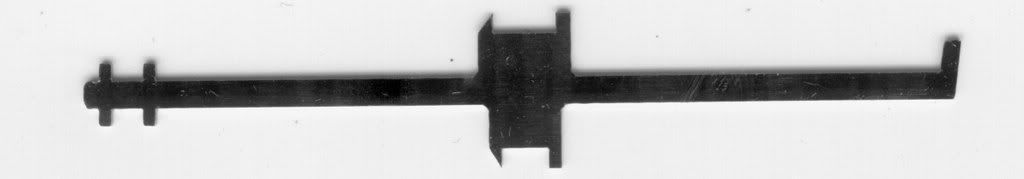

Postby Kranmer » 6 Jul 2008 0:07
I am looking for a descriptive photo and dimensions on a tubular torque wrench. I have a steak knife here that the handle came off of and its begging me to cut it down to something..

Postby steve0527 » 6 Jul 2008 0:39
The gaps are 1/4" and on the other side it is 3/16"

Postby Kranmer » 6 Jul 2008 1:00
What are the dimensions on the points to points and such. how deep?

Postby Kranmer » 6 Jul 2008 17:08
Its incredibly easy to make but with out very good measurements all around, I can only guess. :roll:
Does anyone have a set of calipers and one of these tools they can spec out? It sounds like I am not the only one who wants one of these in their tool bag and I admit, I am very curious to see how well they work.

Postby jimb » 6 Jul 2008 18:10
Kranmer wrote:Its incredibly easy to make but with out very good measurements all around, I can only guess. :roll:
I'll dig mine out if I need to. The scan that steve0527 posted is my tool. Don't worry about the ends, they are warded picks and if you want warded picks then you will be better off to spend the 10 bucks to buy them and you will get all of them.
As steve0527 said just make the gaps in the middle of the tool 3/16" on one side and 1/4" on the other and leave some length on each end to put tension on the lock. When I bought this it came with a tension tool to use as the pick. You can use anything as a pick that will push the pins down.

Postby jimb » 6 Jul 2008 18:22
I just want to add one thing since no one has mentioned it yet. If you use this method to pick a tubular lock you might have to pick it more than once as when you start to rotate the lock the pins will fall into the next set of holes. The number of times will vary depending on the type of lock it is. The first one I picked with this method only required me to pick it twice but some locks will require many more times.
If you was too only turn it half way between the next set of holes you might be able to make something to imitate the key or come up with some sort of a plug spinner to avoid picking it more than once, but I have never tried this.
