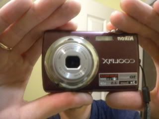

What are you using to shoot these? an actual camcorder or a digital p&s with video capability?

Ahhh... gotta preset the zoom and be far enough away... I don't think macro mode works with video.

I'll try it farther away next time. I'm not too sure about the zoom, every time I try it everything seems to get pixelated. I'll give it another try. I've been using the manual focus, but I don't like that I don't really have control over the focus (basically it will auto focus to begin with, and then it won't refocus while shooting the video). Which I think is a good thing since the lock isn't going to be moving while in the vice.
Also it has a macro setting while in video mode, I have always turned it on for these videos, as to whether it actually does anything is another story.

Yeah I have that same camera and haven't noticed much difference between macro mode and regular mode. I stopped using mine for video though because the focus doesn't change. more distance should help though.

I think I have figured out the focusing issue.
