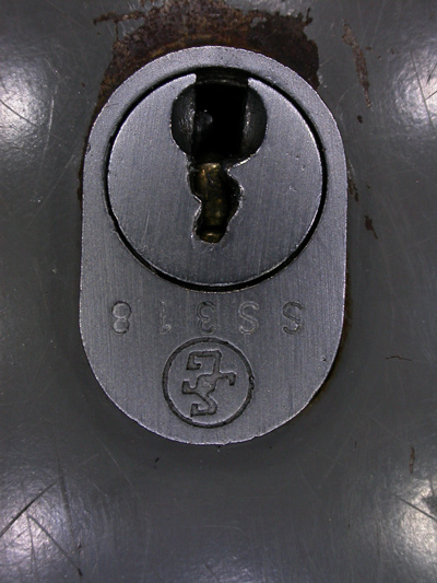

this lil' f***er:
Its inverted as shown and attached to the unused strong box at work (don't worry, im the boss/owner). Only four pins and you can even see the first driver hiding there. Oh how i've struggled with this one. Something about how the wards are laid out. I keep snagging my pick on them and having trouble even identifying pin states. Maybe there is a security pin in there somewhere? Oh, this one has been a . I've gone at it on and off for the better part of 2 hours. I'll likely spend my lunch hacking at it tomorrow. :)
Anyone recognize the brand or type?

I did a search on the SG logo and I'm guessing it is an older Sargent and Greenleaf. The logo does not match exactly, but maybe its dated?
I'm getting the idea from reading up on the SG website (www.sglocks.com) that if this lock is indeed a Sargent and Greenleaf that it will be... how should we say this... substantially more resistant to picking than a Kwikset.
:shock:
Perhaps I should practice on something else first.

Postby Varjeal » 18 Oct 2004 21:05
That is indeed an S&G lock... pretty sure there's five pins and no security ones. If it's been installed upside down like that for quite awhile you may want to lubricate the lock...you may also have a collapsed spring that's giving you trouble.
There's nothing particularly difficult about this lock (all things being equal) so have a go at it. :)

Postby Stevo » 19 Oct 2004 17:58
Got it! :D
Just four pins and no security pins. Once I figured out where to put my wrench and how to negotiate the wards I had it. The 4th pin was a pretty deep set while the 3rd was quite shallow. It took a hook to get around the corner on that one.
I picked it within a minute on my last go of it. I've learned much from this lock and will contine to pratice it until I "pwn" it. :)
