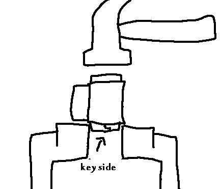

they bend in the back of the plug a little bit so turn it pi/2 radians and push really hard. if it still doesn't come out put the outer shell resting on a clamp and hit the back with a hammer.

Postby Oaklandishh » 29 Oct 2010 14:16
I meant vise, not clamp. I even made you a diagram.

Postby szekely » 29 Oct 2010 17:05
Turning it farther didn't work so I ended up using the hammer idea. First few hits didn't do anything but then it loosened up and I got it out. I think my shell cracked when I was prying off the part of the padlock that kept the shell in place. I had to use a hammer and screwdriver which might have damaged the shell. Thanks you for the advice :)

Postby Raymond » 31 Oct 2010 12:10
Master padlock plugs are held in by bending one part of the shell into the groove in the plug. The plug will come out and go back in if the plug is rotated so the bottom of the keyway is inline with the bent part. The bottom of the keyway is flatter than the rest.
If you have boogered up the plug and shell, and scratched it, you will just have to smooth everything out ahain before it will fit.
