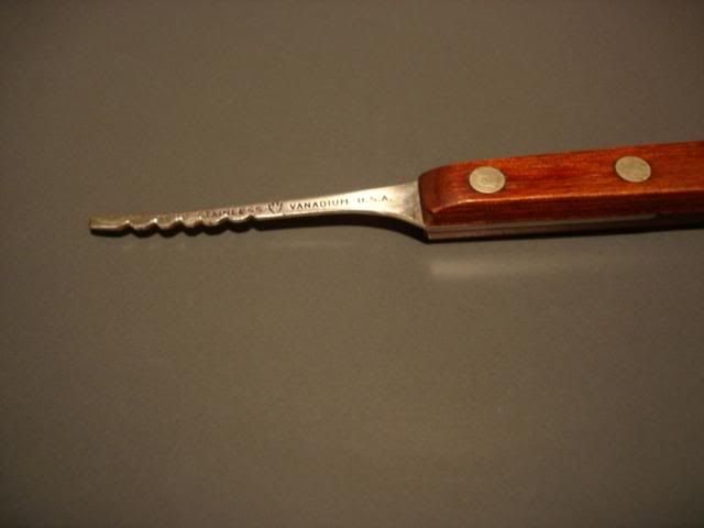

Is there such a thing that combines a pick and a wrench into one tool? I was playing around on my garage one day and realized I lost the keys to my gang box, if anyone has owned a gang box you know you can't just cut the lock off with bolt cutters, a grinder or even a torch because the lock is enclosed in 1/8" thick steel. I could have drilled it out but like i said I was playing that day so I decided to try and pick it. With the wife away I grabbed an old steak knife and fired up the Dremel. My very first attempt at making a pick worked perfectly and it worked without a tension wrench! I'm not a seasoned locksmith and that lock was my first, meaning I've never tried to pick a lock before, any lock, ever! So obviously I was pretty proud of my pick and my ability to use it and I would have posted a picture of it below but I guess I need permission. So without actually seeing my pick let me down gently if it is common and everyone has one.

The tool I made is pretty thick, much thicker than the other picks I've seen on this site. The lock on my gang box is much larger than a basic padlock so I would think using a normal sized (thickness) pick and wrench wouldn't work but I really don't know. I'll post pics of the combo tool as soon as possible.

Finally figured it out but the funny thing is I snapped it in two trying to pick another lock, lol! Oh well it DID worked great! Image

Well it has the shape . profile of a rake, not usually a tools meant for picking and tensioning the lock at the same time. Than again, it worked for you and I must say I'm impressed by the way you made your first pick, very nice job!
I would switched to other materials such as street sweeper bristols, wiper blade inserts or feeler gauges, I'm betting you could make some awesome picks with the right material ;)

Instead of steak knifes I grind down pairing knifes to make my one handed picks and jigglers its a LOT less grinding.
http://www.youtube.com/watch?v=p7rH-eJ1V2o
http://s130.photobucket.com/albums/p272 ... etool3.jpg
