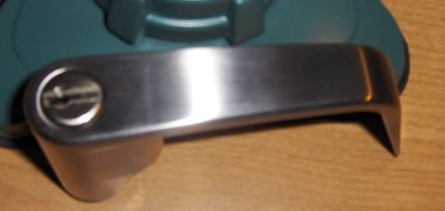

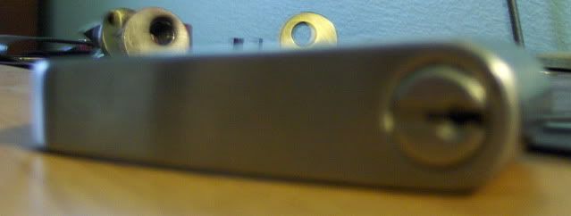

squelchtone I think that it's just a conventional schlage lock. I checked with the maintenance guy and he had no idea. He takes the new locks to a locksmith and they install it. Here are a couple pictures:

Photo's are alittle blurry, but it looks like a normal Schlage to me.

Looks a bit more like Corbin to me. Do you have a key? What does it say on it?

mcm757207 it is definitely a Schlage because that's what the company I work for buys. It doesn't say anything on it. Also, I don't have a key for it. The building maintenance department had it in their "spare parts" box and gave it to me.

Postby ALLS London » 31 Jul 2011 14:25
it's a Schlage AL series Neptune lever- it's 5 pin unless it's been re-keyed. if you work in a large institution, it's probably master keyed, which is often 6 pin, but usually easier to pick.
If you don't have the key, shim it open and remove a few stacks while you get used to it. counter clockwise usually works best for the shape of the keyway, and start with fairly light tension while you get the feel for it.

Postby mcm757207 » 31 Jul 2011 18:24
The reason I suspect a Corbin cylinder is because the plug face is slotted. I've just never seen Schlage do that.

Postby Fire Fox » 1 Aug 2011 16:29
ALLS London, I checked today with the maintenance guys and it is indeed master keyed.
mcm757207, I found out that the cylinder is bought separately from the lever. I wrote down the numbers on the cylinder box, but forgot it at work. I'll try and remember to bring it home tomorrow.

Postby Fire Fox » 2 Aug 2011 16:39
Ok, I checked on the lock the cylinders come in a box marked 40-100 626 SCN I have figured out that this means it's a conventional, satin chromium plated, but I don't know what the SCN means.
