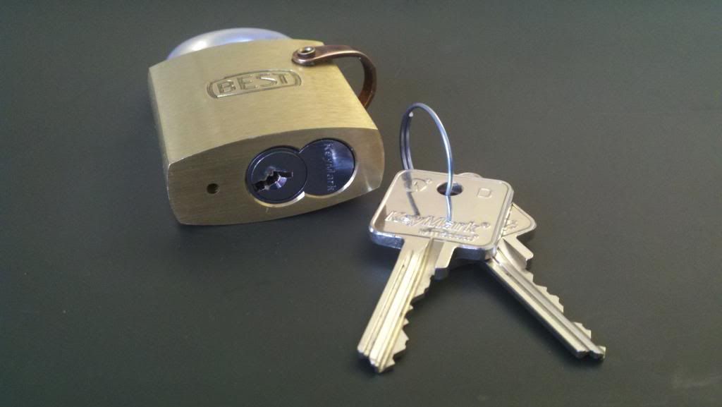

Speaking of tight keyways, I got that KeyMark keyed up! 8)
I agree with fgarci03, slimline picks do make a tremendous difference. When picking a keyway that is very tight, I put the pick in at an angle and make a sort of rotating or spinning type of motion to lift the pins up. The more you practice with tighter keyways the easier it will become. I am still not real good at it... practice, practice, practice. :)
