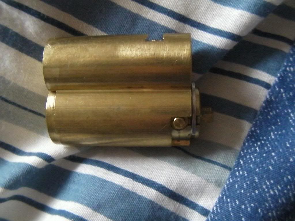

I made a rookie move while I was repinning an ABUS 83/45-200 (I like this for security pin practice because the tolerances are really tight, but the keyway isn't.) I was planning on practicing with a couple of combos being that I have the day off :) . Unfortunately, this happened:

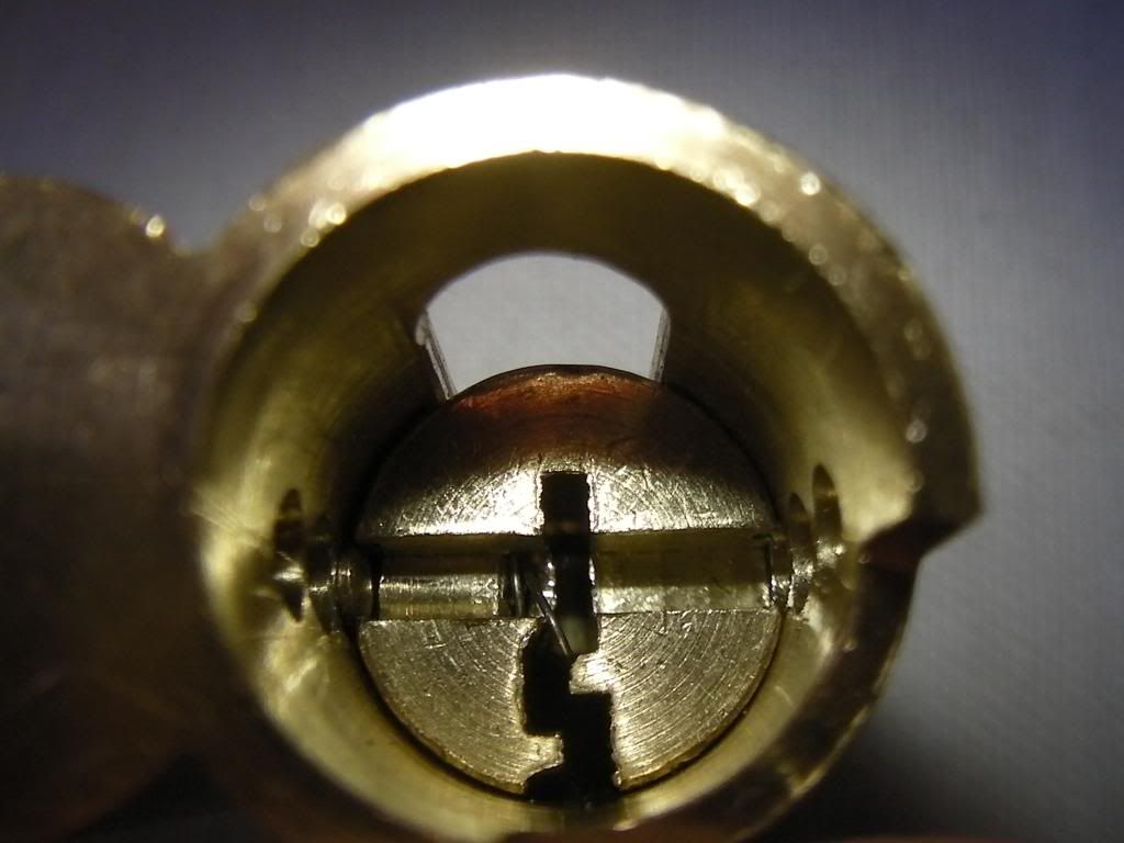

Here's a picture that might help me explain what happened:
That pin you see in the image above had become lodged in one of the pin chambers! Totally a rookie move, I was too careful by half when trying not to let the bible unload the 5th driver chamber into the 6th key chamber of the plug. I was pretty depressed and was not able to get that pin back into the plug by rapping or using a small safety pin to push it back in. I was able to recover the lock, though. Here's how:

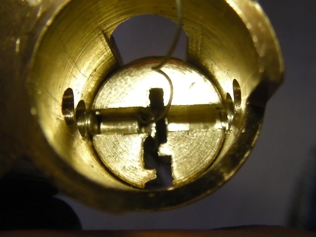

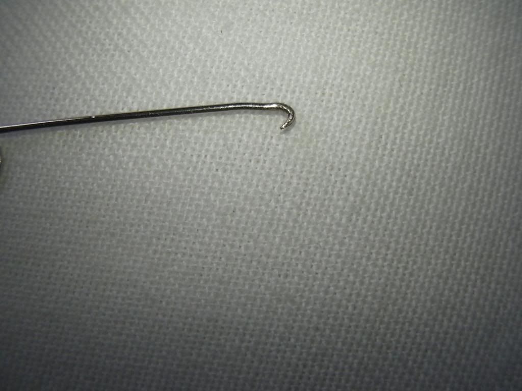

I bent the ends of two safety pins like such with a pair of needle nosed pliers:

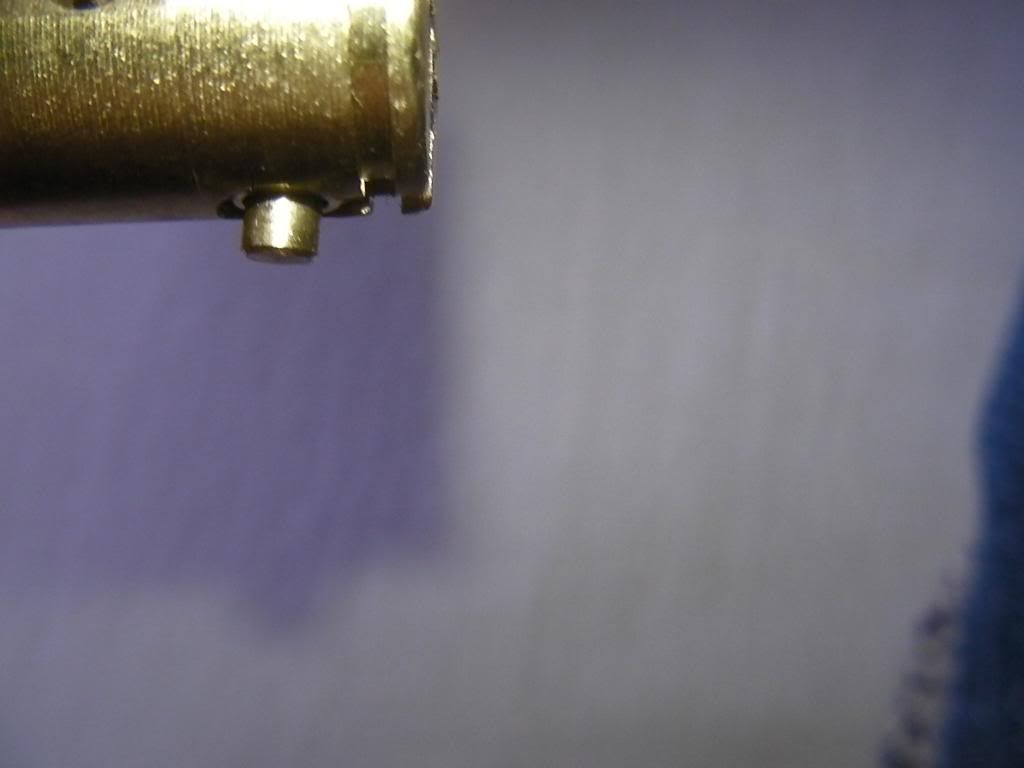

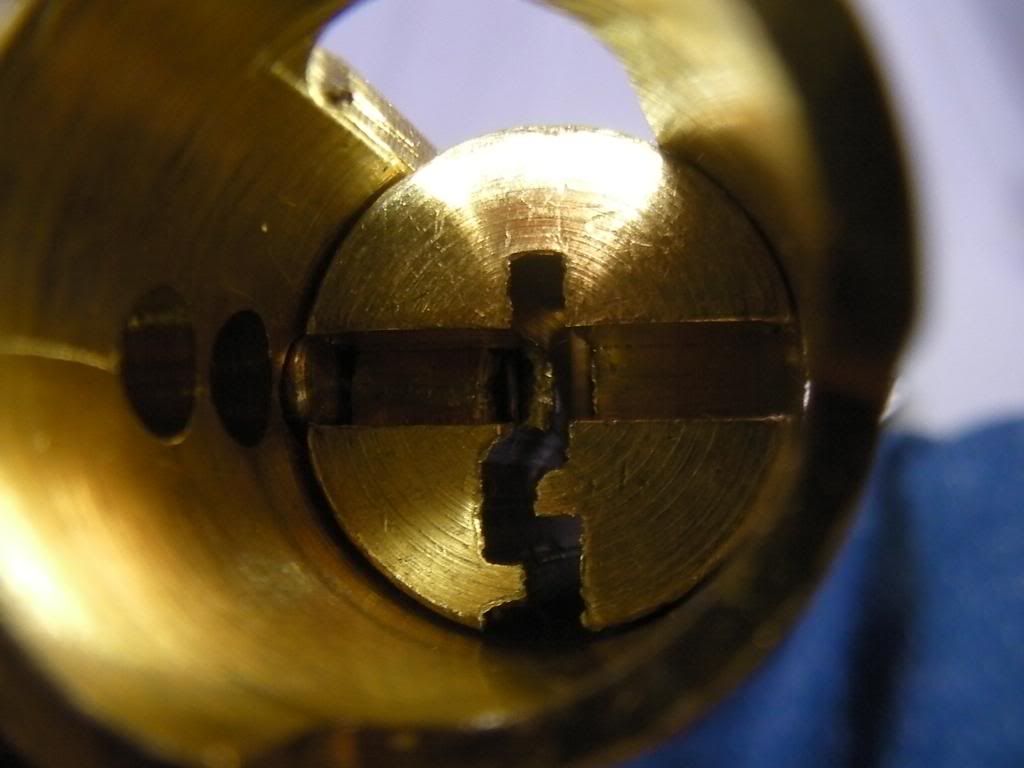

Notice that the back of the retaining pin chamber is exposed, hard to see but from the subsequent pictures you should be able to figure out the area I'm referring to:

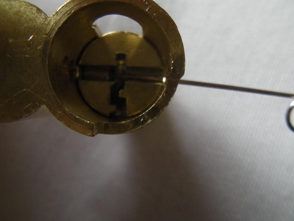

I was able to work as many as two coils out of the small opening using the safety pins like so:
From there I was able to use the hook-ended safety-pin to yank a coil free from the chamber:

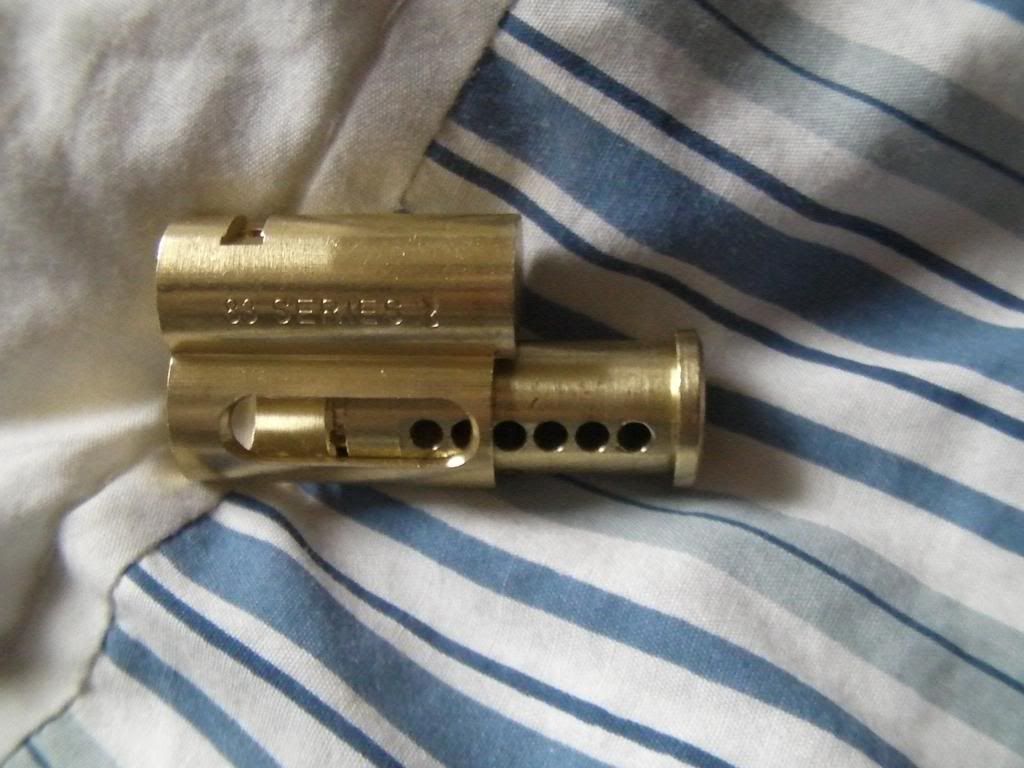

Using a pair of needle-nosed pliers, I was able to grab the end of the spring and remove the entire spring:
From there, I let gravity allow the pin to fall back into the plug and my lock is now able to repin, only disadvantage is that the plug can now overturn. I'm okay with that, but will have two new locks of the same make on the way soon. I noticed that something like a collet is used to keep the pin in there. If I felt like it, I could use a threaded steel with the correct taper and yank the collet out (yeah right, I know; but maybe! :D ) and replace spring and pin and re-secure the collet. But a new padlock of this sort is only $30 maximum. Hope this is of use to someone! If I could've done something better, please tell me. I welcome any constructive criticism.
