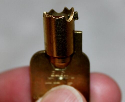

First go at impressioning something different:
Image[/URL]
and first go at inserting an image, please don't be too hard on me if I messed up.
