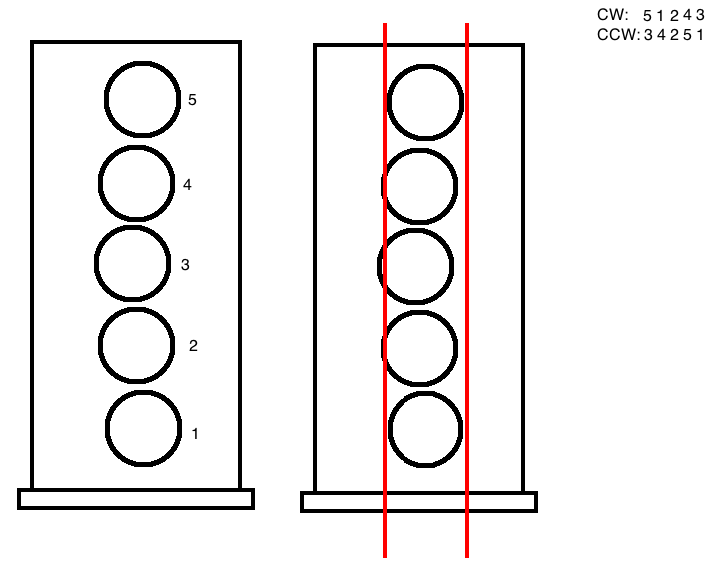

I hope this diagram I found on google helps where my description may fall short:

In the picture, wouldn't 1 bind first on clockwise picking?

Postby Squelchtone » 26 Nov 2013 9:28
spoonzor wrote:In the picture, wouldn't 1 bind first on clockwise picking?
Don't get hung up on the pic, its something I pulled from google image search and is not meant to be accurate to the millimeter. the diagrams maker seems to think 5 then 1, but I see what you see that 1 looks like it would be first. I'm not sure who drew it, I'm sure they were also just trying to make the point of how it works, only so much you can do in Windows Paint. =)
Keep practicing, I think you're getting it!
Re: Binding order
Postby spoonzor » 26 Nov 2013 9:31
actually on second look the picture looks to be correct after all! I was assuming that all chambers would be exactly round, but obviously they might as well be oval shaped

Postby YouLuckyFox » 13 Aug 2014 18:25
Squelchtone wrote:I hope this diagram I found on google helps where my description may fall short:
Dude, sweet that you googled a diagram I made from my Photobucket account!
