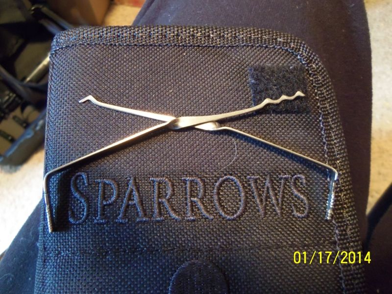

Any chance you could post a photo of yours?

Postby smokingman » 15 Jan 2014 23:28
I gave my titaniums to my brother for Christmas, but I have some stainless ones I made and can take a pic of them.
I have customised them too, they are a bit different but illustrate the concept.
I will post as soon as I get a pic uploaded.

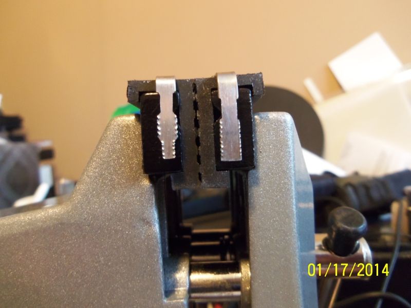

Postby smokingman » 17 Jan 2014 14:05
teamstarlet wrote:Any chance you could post a photo of yours?
Here,s my home made fauxgotas, ith the modified tips for more funcuntionality,
smokingman

Re: Is it weird that my go-to tension wrench is a Raimundo's
Postby Divinorum » 17 Jan 2014 15:54
Very nice work smokingman. I like the concept of the double sided tool. Less to jam into a case or carry.
Postby smokingman » 17 Jan 2014 18:14
Divinorum wrote:Very nice work smokingman. I like the concept of the double sided tool. Less to jam into a case or carry.
Raimundo invented the bogotas , I just changed the tension tips to a serrated/reduced width
so to get a better grip in the top of keyway and not scrape the bottom of the cylinder and cause jamming of the
plug.
Friction at the bottom can cause the plug not to turn even when the pins are at shear.
