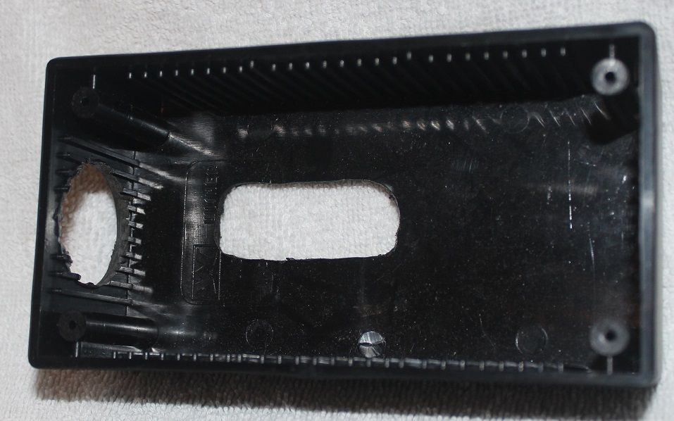

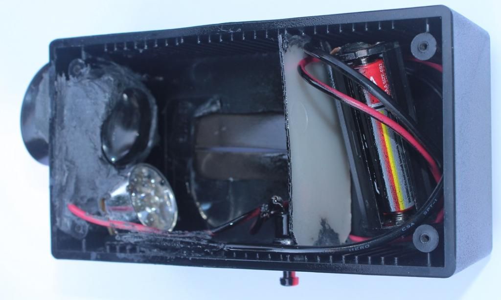

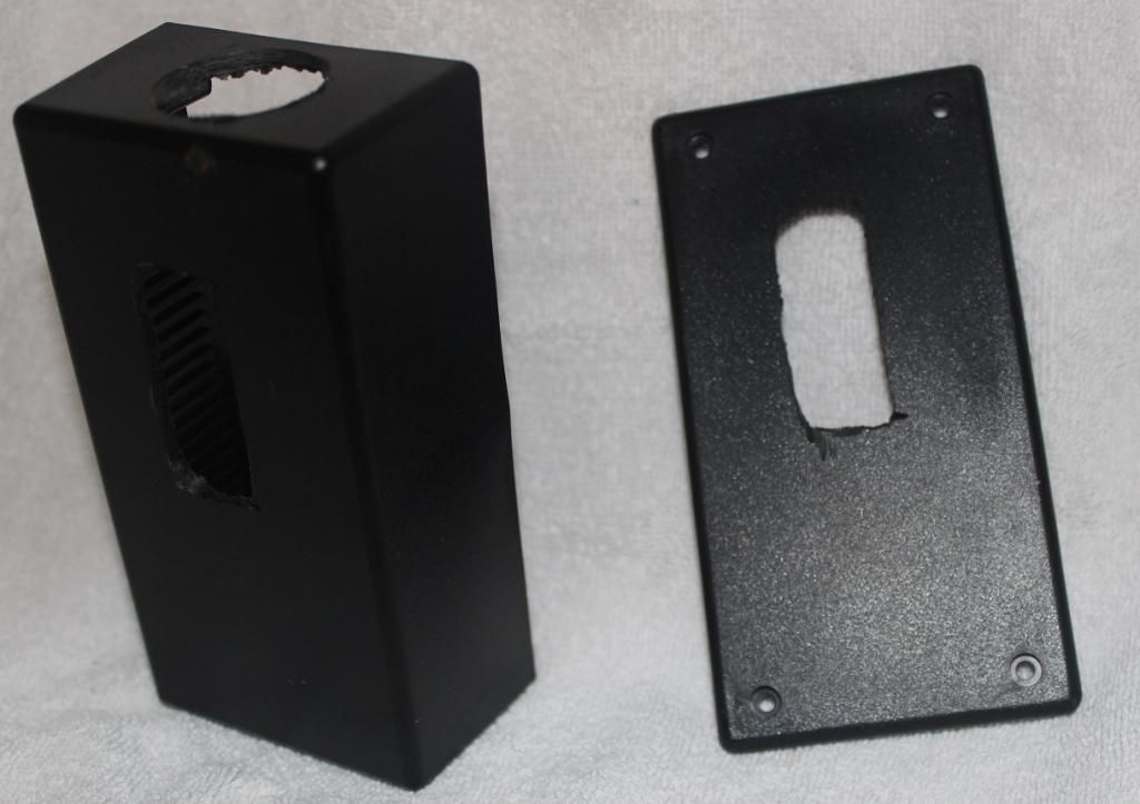

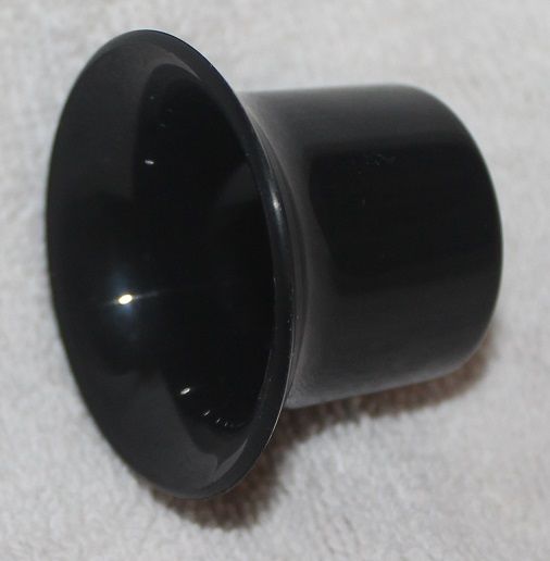

I have tried many different techniques, and must admit, a 3-5X magnification with sun light is ideal. That being said, sometimes sunlight is not available, or you need more magnification. I made myself a magnifier, here's how:
First you need: A) a project box (from an electronics supplier), small, ± 2-3 inches by 4 inches by 1 inch. B) A watchmaker's eye loupe. C) A cheap dollar store LED flash light, not too big, think: 2 or 3 AAA. D) A normally off push switch, and E) a door sweep, ideally the brush type.
So, you cut out 4 holes in the project box, one round hole for the loupe on the smallest side (I will refer to it as the "top" from now on), and two facing each other on the largest sides, rectangular holes, and a small hole for the switch on one of the other sides, positioned in such a way as to make it easy to push on with the same hand that holds the viewer.
Then, you rip apart the flash light. What you want to keep in working condition are the DELs and the battery adapter.
Epoxy the DELs,and the eye loupe next to one another on the top.
Epoxy the brush door-sweeps on the sides.
Now all you have to do is wire the little switch between your LEDs and your battery adapter and close the box.
I apologize for the pictures, I am aware they aren't perfect. I didn't have any brush type door-sweeps at my disposal when I built it, so I used squeegee type door-sweeps (not quite as elegant unfortunately).
I glued a piece of plastic to keep my batteries from wobbling around and then spray painted it (because it was white and reflected too much light).
The eye loupe I used is Bausch & Lomb 10 watchmaker's loupe.
What you'll need to work out by trial and error is the ideal distance between the rectangular holes for your door-sweeps, by which you will be introducing your key, and the focal point of the loupe. You may also want to try tilting the loupe. I find if your loupe is tilted: 1. It leaves more room to figure out how to glue your DELs in place, and 2. The angle provides a second angle to view the key if you turn your viewer around and view from the other side.
The whole thing cost me around 30$, the loupe being the single most expensive component (around 10$).

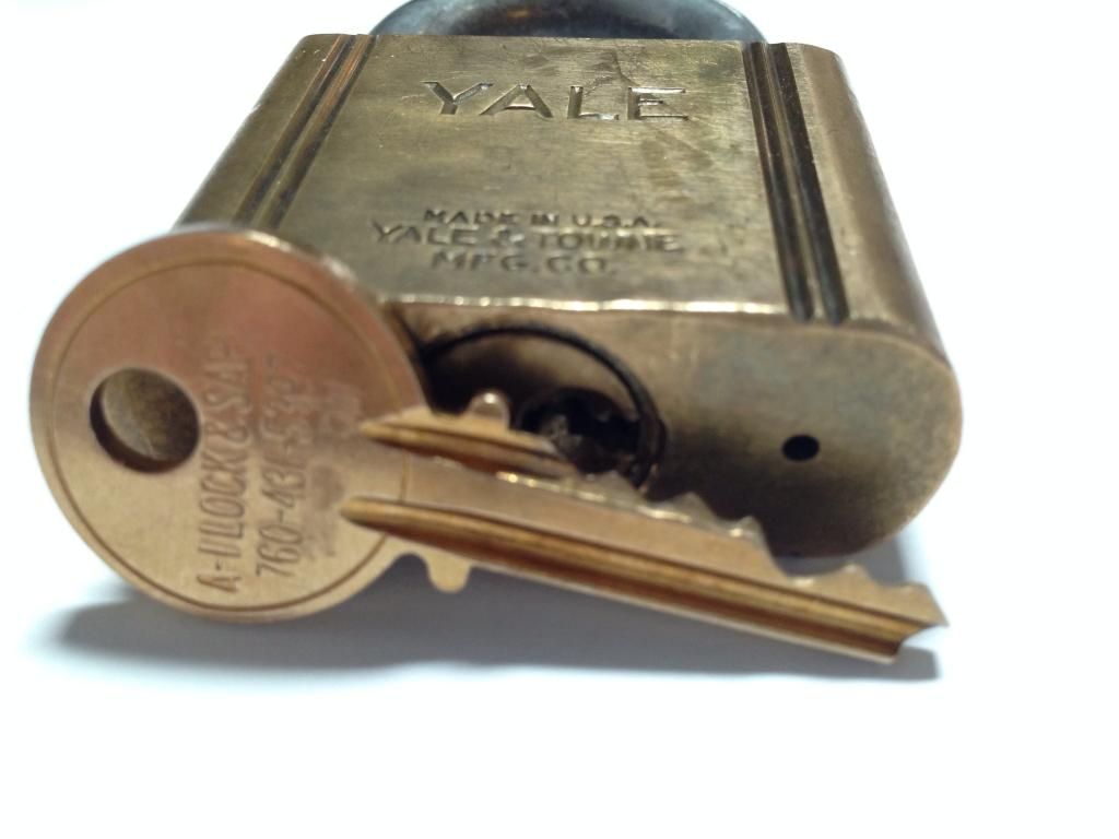

I have lately been getting into impressioning locks, and I have been using a jewelers loop. But I tend to agree with Gordon, like usual... :lol: The more I practice, the more it seems that my naked eyes can pick up the real marks. The loop tends to show way too much! Here is a cool Yale lock that I picked up in Oklahoma and got a key impressioned for it in a couple of tries:
The pins on this lock are so worn down, it was really hard to see the marks. But, the fact that I was able to do it and I had the patience to keep working at it really helped my skills grow so I'm happy that I stuck with it! What helped me more than anything else was using a calipers. I bought another Yale lock off of eBay and this one I actually impressioned in one go! That's a rarity for me, it usually takes me two or three blanks before I get one that works. I tend to go a little bit faster than I should… and less I am impression in a four pin Master lock :lol:
