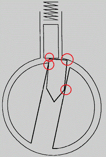

Postby Daedalus Erebus » 7 Aug 2015 10:57
Here is what I think is happening:
The four circles show where I think the binding is occurring which prevents a key pin from free floating in a basic pin tumbler. The downward pressure from the driver pin puts just enough pressure on the top of the key pin, while at an angle, to cause binding against both the hull and the plug, which prevents the key pin from falling back into its "down" position.
This is just what I believe is happening, as I cannot actually see what's going on. Is this even a possibility?

Postby FarmerFreak » 7 Aug 2015 19:12
That is an accurate picture. None of those contact points would prevent the key pin from falling down. To the contrary, the contact point with the driver pin would push the key pin down until the driver pin is resting on the cylinder. At that point gravity would take over, and the only things holding the key pin up at that point would be dirt, grease, oil, a burr in the lock etc..
