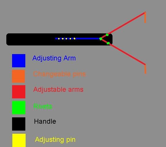

Postby master in training » 2 Mar 2005 9:44
hmmm, i can see why thats a good point, i've seen a tool before for tightening certain types of bolt, but it looked like the would be good for a tension wrench with some modification, it was basically an arm with a c shape the the end, like this --------c going off the c at right angles were a little bar, if these could be made very thin and short, one could go in the top of the lock, one in the bottom, leaving the entire keyway and lock area free to work on. im pretty sure the idea had been thought up before, but i've never seen a wrench like it.

Postby master in training » 2 Mar 2005 11:31
thats sort of it, but not quite, i'll see if i can make up a design of what i thought of and post it so you can see what i mean.
thats the basic idea though, that it fits in the top and bottom and allows the lock to be turned.

Postby master in training » 2 Mar 2005 12:29
this is sort of it, but the picture is awful as always, i will do my best to explain it.
WARNING: the picture is quite big!
http://img.photobucket.com/albums/v727/masterintraining/tensionwrenchdesign.jpg
basically, when the blue bit is moved left to right, the red bits move up and down (away from each other and closer together), this gives the ability to change how far apart they are so it can fit different locks. the yellow bits are simply a way of securing it so that the distances dont change while its being used. the green bits just show roughly where it would be riveted. the orange pins are interchangeable so that you can have different pins for different locks, longer shorter, thicker, thinner etc.
i hope this explains the picture a bit, it might be a totally useless idea, but its just something i came up with when i was sitting around waiting for my pc to load!

Postby master in training » 2 Mar 2005 15:21
they are similar admittedly, but still not exactly what i pictured when i thought of it, i've never seen those before, so i was making it up as i went along, my idea seems similar to those already in production, but not the same, possibly for a good reason :wink: but i dont know, so i'll forget about it for a while and most likely see the picture in a few years and think about it again.
