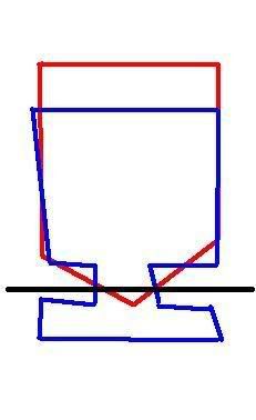

You don't need to take offense at everything so quickly. If you didn't understand my second post in this thread, here's an attempt at clarification through Paint.
Here are the top pins for a two pin lock. The red one is closer to us and is a standard top, the blue is farther and is a spool. The black line is the shear line.
Say the first pin sets first, as seems to be the case for you.
Next, you false set the security pin.

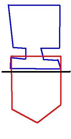

If you continue to lift the security pin past the false set, however, the first pin may become unset; let it unset, and completely set the security pin.

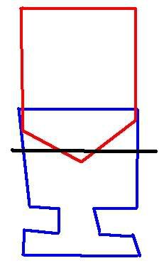

Now that you've completely set the security pin, you can set the normal pin normally, and it'll pick.
This is how it'd work with a two pin lock. With a Master 140, which has 4 pins, 2-3 of which will be spools, you may have to do a bit of jumping around between pin stacks, setting security pins which'll cause others to unset. Keep at it, remember to use light tension, and you'll get it. Picking Varjeal's cutaway from before (5 spools, 1 serrated) was a nightmare with the constant setting and unsetting, but with patience, practice, and the right tension, it'll get much easier.
