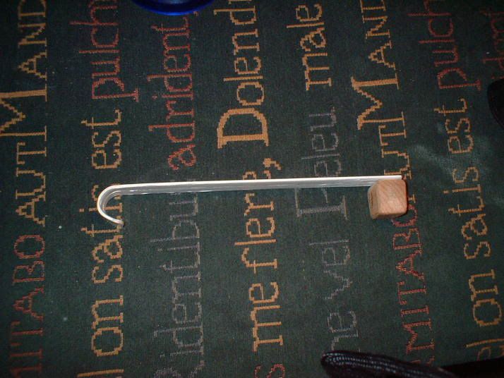

Postby illusion » 3 Jan 2006 17:51
I've posted these elsewhere but I feel they would profit from being here:
a bumpkey hammer styled after the Tomohawk made of PVC for the handle and carved Oak for the striker. Took perhaps 45 minutes to do including carving the wood.
http://i16.photobucket.com/albums/b25/j ... CF0201.jpg
http://i16.photobucket.com/albums/b25/j ... CF0235.jpg
http://i16.photobucket.com/albums/b25/j ... CF0234.jpg
http://i16.photobucket.com/albums/b25/j ... CF0233.jpg
http://i16.photobucket.com/albums/b25/j ... CF0232.jpg
there you go :)

Postby illusion » 3 Jan 2006 19:48
I used it to bump the cruciform lock in my video and it has worked for the other locks I've tried it on.
it would be much better if the end of it had a kind of curve .. I can see how having one of those helps you to grip it - if I make another I'll make sure I include this.
well it has given pleasing results, and I have no complaints. It functions well and the only problems I have with it are aesthetic.
I'm using it to bump constantly - the handle is pretty flexible.. the striker was a kind of experiment, but it seems that oak functions fine as a striker.
Postby zeke79 » 3 Jan 2006 19:54
Illusion,
You may be able to form a curl at the end of your existing tool by putting a piece of 3/4"-1" dowel or steel rod in a vise and using a heat gun to form your tool around it. That may be worth a shot. :wink:
Postby illusion » 3 Jan 2006 20:03
thanks zeke... I'll give that a go tomorrow :)
should be interesting :lol:

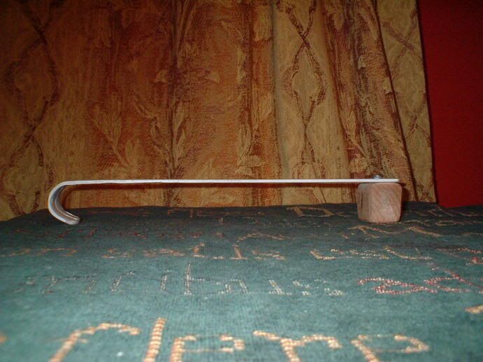

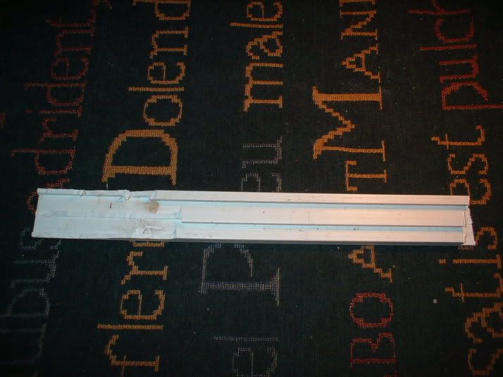

Postby illusion » 18 Jan 2006 19:44
Okay.. so basicaly the same hammer as before, but this time with a loop on the handle.
To bend it, simply point a hot-air-gun at it and wait for 4 seconds - then bend the plastic to the right shape... it will remain soft enough for about 20 seconds during which you will have plenty of time to to mess about with it. After about 1 minute or so the plastic will be as hard as it previously was, and you will have a nice little curve. Of note is that if you fail to make the right shape the first time you can re-heat the plastic to try again.
I am happy with the design, and when I have time I will get some nice clean, smooth PVC and make a better handle - the one at present is pretty dirty but it's the only thing I had when I spontaniously decided to make it...
Now this is it's humble beginning - a piece of PVC curtain track (getting it flat was most of the work lol) :lol:
The hammer on my table:
Another photo because I like it so much lol:
thanks for lookimg :)
