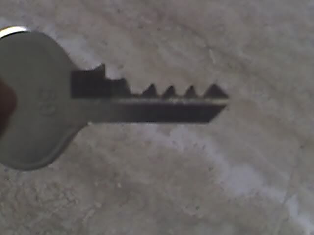

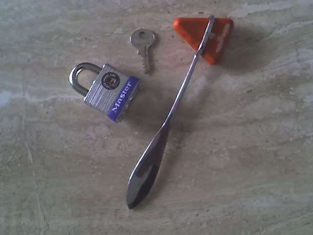

Postby LostGunner » 23 Apr 2006 12:52
I was intrigued by Sublime's (On page 3 of this thread, Oct 16, 2005) idea of using a doctor's hammer, also known as a reflex hammer. I borrowed one from a friend (the only identifying marks on it are "Miltex 1-202 Taiwan") the hitting portion is orange rubber that is pretty compliant. I bought a 4-pin masterlock, got some extra keys cut for it, filed one down to 9999 bump key size, filed a little off the shoulder slipped it (with a little trouble) into the lock banged it a couple times and voila! it opened. There is still much to be learned for me, but a Physician's Reflex Hammer seems to be reasonable choice for a first bump hammer. And at as little as $2 a pop it's pretty economical... Obviously you get the bonus of making sure that you have reflexes.
I know it's a pretty crappy 9999 key, so no need to hassle me, it was my first. Also sorry for the size/low resolution, my dig camera is busted right now so all I have is my phone...
