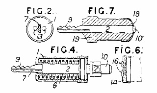

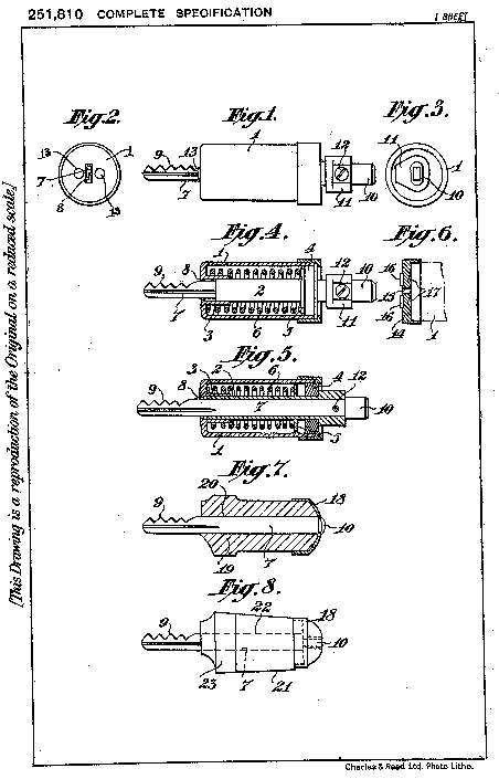

The first patent for something we could call a bump keys was a spring loaded contraption patented by a Mr George Baron, in 1925. It had a 'serrrated like' (his words) protrusion (the bump key_ attached to a body with a sprung section. The idea being you hold the body and whack the back of the tool.
(George Baron 1925)

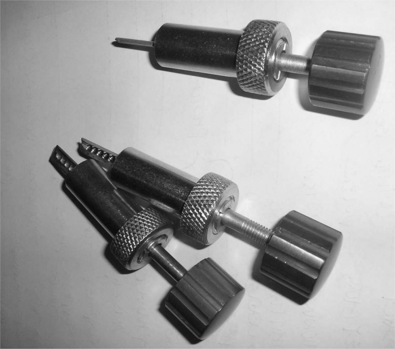

Interestingly enough, you can now buy a tool, very Similar to George Baron's patent, but for Chinese Dimple locks LOL

Postby ASSA » 5 Feb 2008 10:16
Have you tried the tool? If so I would very much want to hear what you think of it.
But considering how good it works with a normal bump key and a bump hammer, this tool seems a bit over-engineered

Postby Good4Nothing » 5 Feb 2008 10:54
Hello
I have these tols (I took the pic) and they are quite poor. I did consider changing the 'dimple rake' ends for a bump keys, but - as you say, it works so wel with a hammer and key - why bother. If you PM me your addy I will send you one of them.
G4N

Postby raimundo » 5 Feb 2008 11:08
interesting, those bump dimple things appear to have plastic heads on them, which could be a problem if the wrong plastic was used.
I recently aquired a set of similiar tools, which are all made with knurled steel fittings, and are very heavy. a photo of the type is in blackbag.com in the menus to the right of the page, click picktools, and its near the bottom of the list. like #14 or so. I have no locks to try them on.
