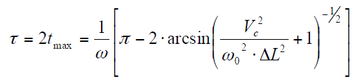

Probably interesting, didn't read through all the formulae yet:
http://jps.anl.gov/Volume6_iss1/Toporov.pdf
(I'm not the author, just found this on JPS.)

It's interesting, but I'm not sure he got it right.
His model apparently assumes that only the driver pins fly away and are returned by the compressed springs, then he goes on with calculating the time the driver pins are on their way.
But I think the reality is different, the key pins will also move.
Master Lock once claimed to have high speed video proof that the pins fly away together and separate only on their way back.
Cheers

mh wrote:It's interesting, but I'm not sure he got it right.
Cheers
mh
I'm no bump expert, so the veracity of what I'm saying is questionable.
But I don't think it's that. I may be confused, but I think that I've seen bumping a lock with the driver pins on the bottom. Like when you use your key with the bitting pointing down. So that way, if it's true that all the pins fly away, there's no way that the key pins return to their position sooner than the driver pins.
And even by doing it with the bitting pointing up, the driver pins are pushed by the springs AND gravity, so on their way down, they would actually be faster than the key pins, thus pushing them down together, because those are only affected by gravity.
