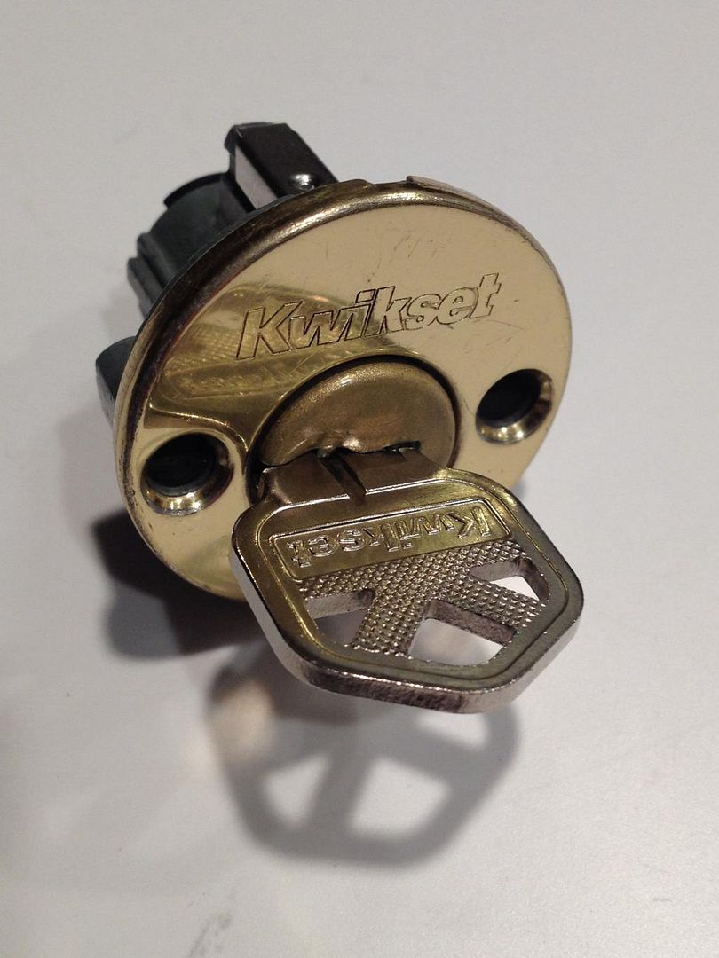

Robotnik wrote:You've got me curious; I'll pin a cylinder up as a test subject and see what happens.
Result is what I was expecting, but had to try. Pinned this up with a 1 in the fifth position and a mid-driver pin that would block the shear line at rest and with a bump key (6 cut on a Kwikset) inserted. Plug turned on the second tap.
The Newton's Cradle/pool ball analogy can be a troublesome one with regards to lock bumping. The transfer of force isn't as clean as with either of these; there are far more variables in play - different pin weights, friction from the cylinder walls and, most importantly, spring tension pressing down from above.

Robotnik wrote:Result is what I was expecting, but had to try. Pinned this up with a 1 in the fifth position and a mid-driver pin that would block the shear line at rest and with a bump key (6 cut on a Kwikset) inserted. Plug turned on the second tap.
