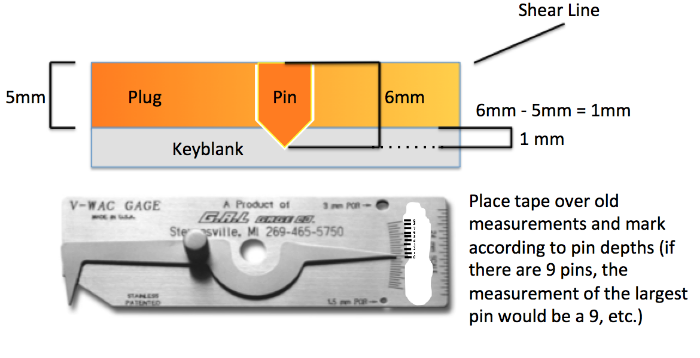

You bet, let me know what ends up working. Nice signature, bytheway! Also, you may have thought of this but here's an idea I thought of since it is late at night. I guess if you had access to the back of the lock (so that you could get an Inner Diameter measurement between the Shear Line and the top of the Key Blade using standard Vernier Calipers--not familiar with Euro locks this may not work, but I have a DOM dimple lock that this measurement could be be made on from the back of the lock) you could subtract the distance between Shear Line and the top of the Key Blade from the pin length and get a very accurate measurement of the depth of the dimple. This is hard to explain so here's a choppy diagram I whipped up:
I know very little about dimple locks, let me know if this would or wouldn't work.

One of those D'oh moments... Yeah that should work just fine, and no need for me to get an expensive instrument for that purpose it seems. You would simply disassemble the cylinder and measure the key pins and the plug from the rear. I might still need to get the tool for making self-impressioning keys for these locks though, which I will eventually do.

By the way, that method of using the key pins and plug to take measurements is also pretty accurate. Measurements I took that way are only about 0.08 to 0.10 mm different from the readings I get off this tool. I think that has to do with the effective plug diameter, as it is a bit less than the actual plug diameter.
