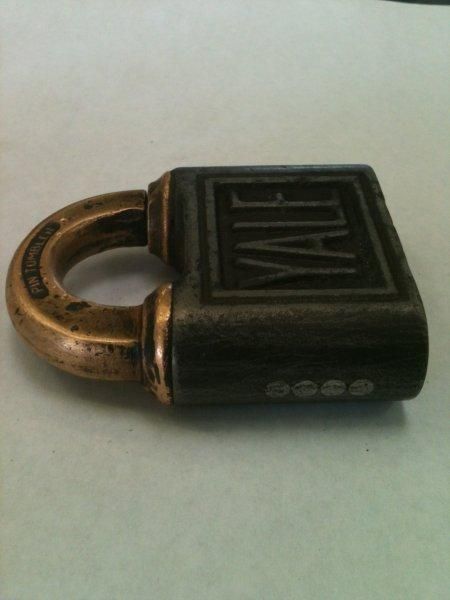

Hey guys-
Posting for a friend on Garage Journal who bought an old toolbox with this Yale padlock still attached:
1) does anyone have an approximate age of the padlock?
2) the lock is stamped UR 6472, is this a blind code for the key, and if so, would someone be able to make a key to this code?
Thanks!
Jeff

Postby Evan » 12 Aug 2013 17:17
It looks like an old WWII era Navy push-lock...
The plug is attached directly to the shackle...
There are threads on this site which discuss these types of locks in greater detail...

Postby alockguru » 13 Aug 2013 19:29
I doubt it would be hard to get a key made for it. Take it to a local locksmith. Looks like it would impression pretty easy.

Postby Raymond » 18 Aug 2013 18:43
Double check if the lock has 5 pins or 4 pins. If it has 5 pins the cuts should be 22343 (bow to tip).
