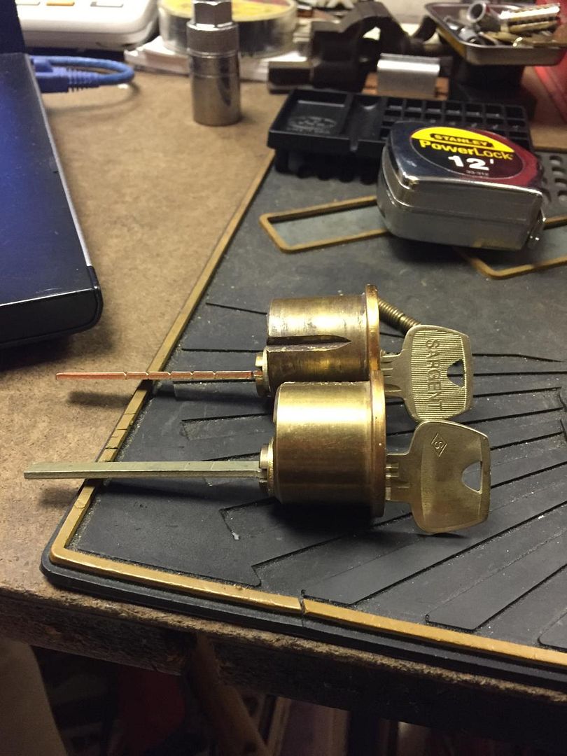

bill, is your cylinder's tailpiece the multi section break off to the correct length type or is it the square shaft? The square shaft was for FOX "police style" multi point lock (as far as I know)
In this case a regular series 34 Sargent rim cylinder with lazy tailpiece will work because it mates to the plate the OP has. that plate has a gear drive inside that goes to the square shaft that goes into the lower hole in his door and then actuates the mortised mechanism. (Just making sure we're on the same page here, because it sorta sounds like you might have a cylinder with a square shaft, not the flat break off pre-scored typical rim cylinder tail piece)
here'a s FOX lock taipiece (square shaft) http://www.reisshardware.com/index.php? ... ts_id=4830
here's a normal tailpiece on a rim cylinder: http://guide.alibaba.com/shop/us-lock-u ... 71306.html
OP do you need to have a Sargent cylinder or can it be generic or another brand? I think you just need a 1 inch long rim cylinder with lazy tailpiece. That should be easier to find on ebay or amazon.

Postby jeffmoss26 » 3 Mar 2015 20:08
Here are a couple:

Postby royrogers » 3 Mar 2015 20:40
Squelchtone wrote:OP do you need to have a Sargent cylinder or can it be generic or another brand? I think you just need a 1 inch long rim cylinder with lazy tailpiece. That should be easier to find on ebay or amazon.
The only concern is where the screw holes are located, mine are slightly above center. If they're all like that, a generic or some other brand should be fine.
