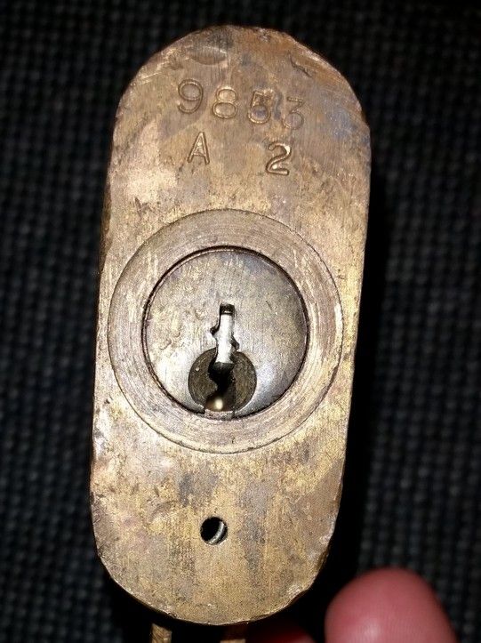

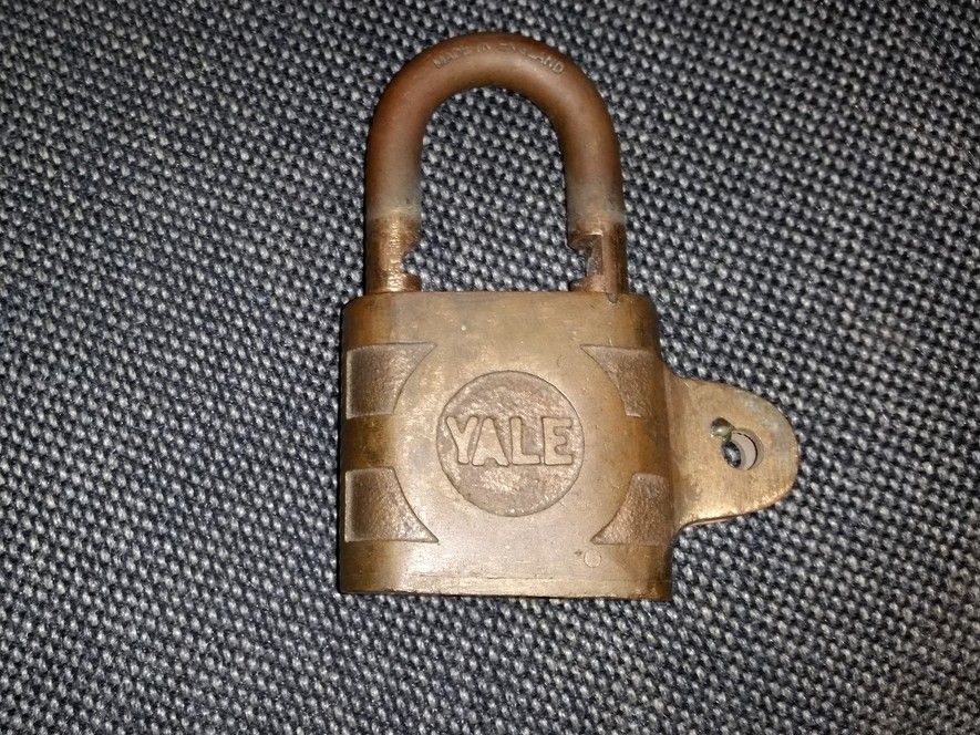

Picked up an old Yale padlock from the markets without a key. For the price of a cheeseburger. Not really into old locks but for the price, I couldn't say no.
I raked it open pretty easily and was surprised it was fairly shiny and clean on the 'inside'.
It has "PCC" stamped on one side, no idea what it was used for.
Does anyone know what keyway it is? Might have been a restricted keyway. I might try and impression this lock. I had a look through the silca key catalog but couldn't find it, there must be a bigger catalog somewhere.
Here are a few pics.

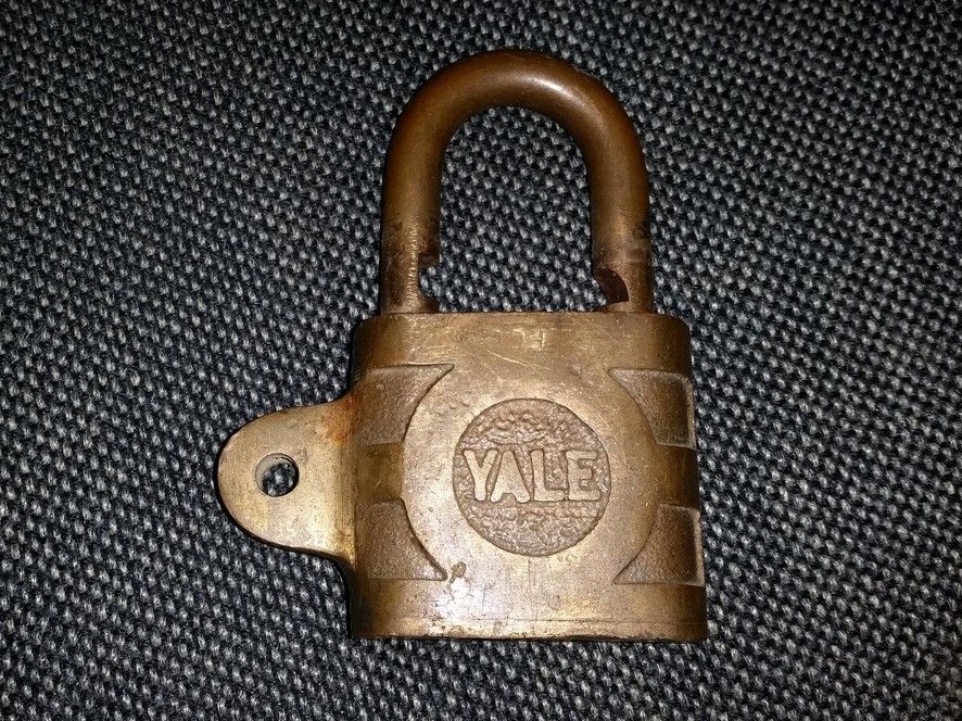

The chain holder seems to have been added on, I assume not by Yale but you can see marks where they have hit it with a grinder.

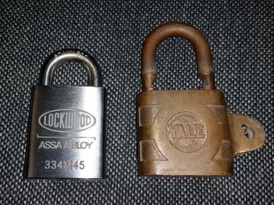

I'm not sure if this was used in Australia as most of the time, Lockwoods are used for commercial and government stuff.

A few guesses here. PCC could stand for 'Prospect County Council' which is a confusing name as it was an electricity utility covering west of
Sydney through the Blue Mountains to the Tablelands, but there could be other entities abbreviated PCC in Australia.
The shackle is stamped 'Made in England' - Yale supplied the Australian and New Zealand market mostly from England.

The illustrated padlock seems to be one of the YN profiles. The number 9853 would be the system number and
A2 the change key reference. Yale did not stamp profile references on plugs or supplied keys (but stamped the two profile letters
on blanks supplied to the trade).

I have hunted out a local NZ locksmith supply catalogue from 1967 and it has a page with diagrams of British Yale
multiplex sections. This padlock almost certainly is a YN-BC section.

After quite a few pages I was finally able to find a 'drawing' of the Yale YN BC keyway it looks like everything matches except one ward. But if it is a multi-broach as you say it probably fits. The BKS BK3-1 also still looks like a promising key to try.
Getting a hold of these keys easily or on the cheap is probably what will stop be from bothering with this lock.
