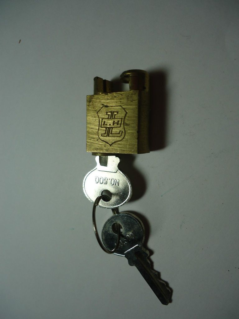

Hello all
I am new to lockpicking and am interested in vintage/antique locks
I just bought this little number for $10 off of someone and before I receive it in the mail I want to share a photo of it and see if anyone has any information on it
Any info that anyone can give on this lock would be super, as I have found diddly squat
Thanks
Miles :D

Hello and welcome to the forum. Remember the old rotary phones? That lock was used to lock the dial and prevent someone to dial a number. You could answer the phone but not make a call.

Unless you were good at using your finger on the button that 'hangs up' the phone. Then you could still make calls. My sister and I were pretty expert at it. It was a game for us. :twisted:

Wow, you're kidding, that's awesome, thanks for the reply :)
