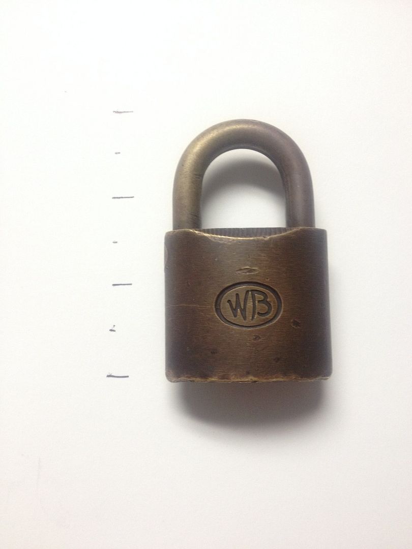

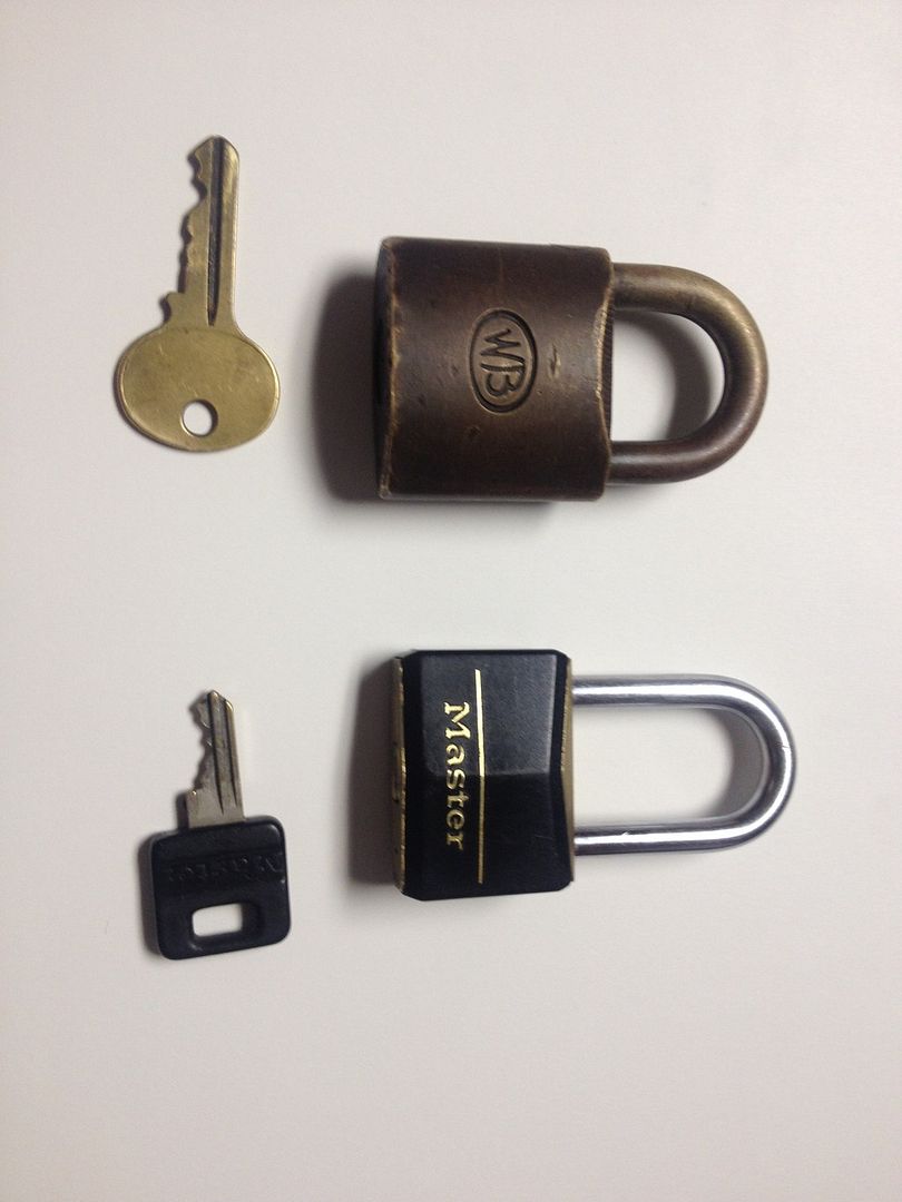

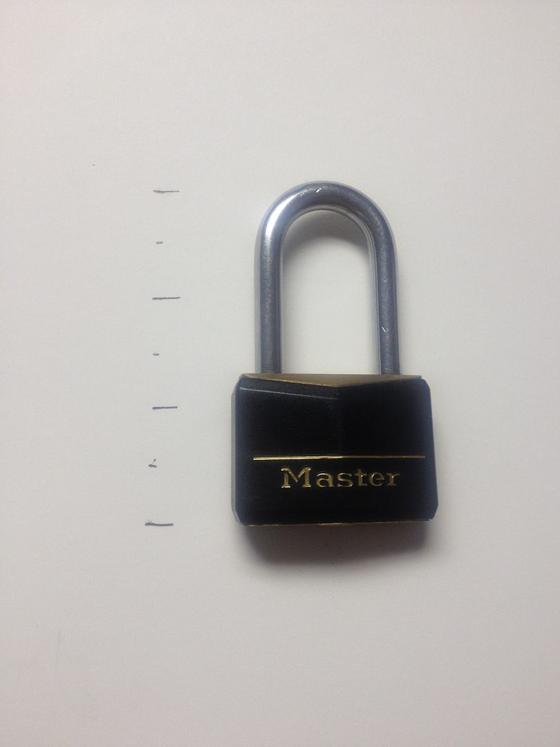

Hello locksmiths and enthusiasts. I have been teaching myself how to pick locks mainly out of curiosity and I found these two locks in my garage and decided to fiddle with them. but no matter what I try I cannot get them open. I think the all WB lock has some form of a safety pin like a spool pin because the lock will spin a little like I got that pin up but then if I try to push that same pin any more it wont budge. so I put less pressure on the tension wrench (not sure what its called) and continued pushing and im pretty sure I got it up. but anyways could you guys tell me if they do have any safety pins and also how many pins in general for each of the two locks. im having a hard time finding info on them because I don't know what models they are. any help would be appreciated.
http://i1159.photobucket.com/albums/p63 ... zlfcik.jpg
http://i1159.photobucket.com/albums/p63 ... hdjlb7.jpg
http://i1159.photobucket.com/albums/p63 ... ixzemm.jpg
(the big ticks are inch markers)

There are no safety pins in any WB I have picked. Sounds like you have been picking the pin correctly, then ease off tension and overlift the key pin above the shear line.

In case it helps your searches, spool, mushroom, and serrated pins are normally called security pins, anti-picking pins, but not safety pins.
