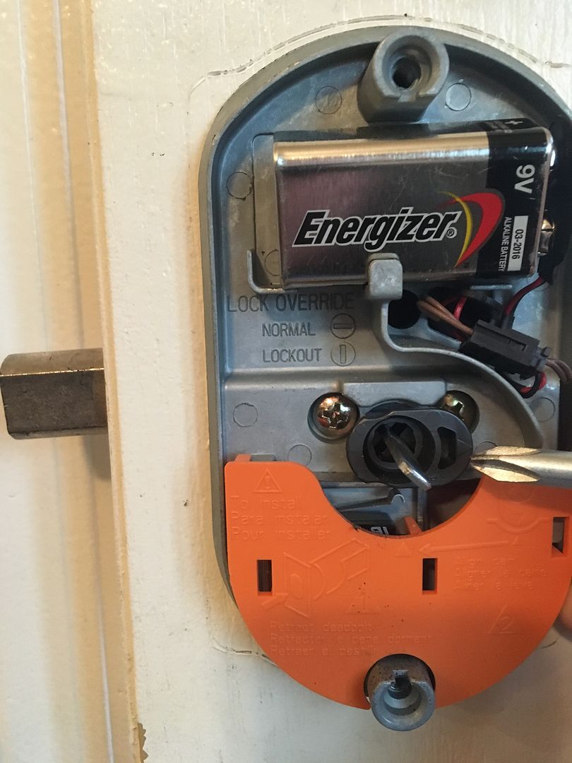

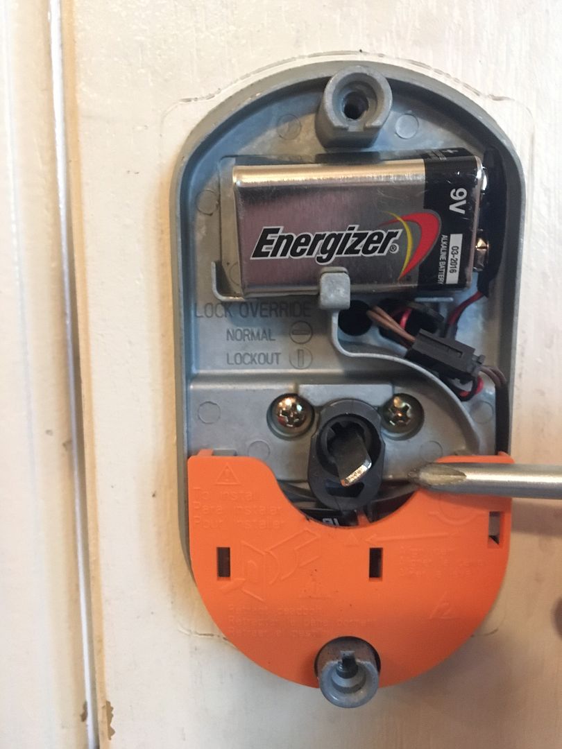

Postby GWiens2001 » 29 Dec 2016 9:53
The lock was installed with the brown tab inside 90 degrees out of phase. Take the lock apart, turn that brown tab/lever 90 degrees, and reinstall it.
You can verify this by going to your back door lock (which is working correctly). Start with the door unlocked. Press the Schlage button (the same way you have been able to unlock the front door), and you will be able to lock the door. But it will not work for unlocking it. That is the way it is supposed to work. They call it the "Lock and Leave" feature.
You can also program the lock to block that way of locking (or in the case of the incorrectly assembled lock, unlocking) by that method.

Postby GWiens2001 » 29 Dec 2016 10:15
Here is a .PDF from Schlage that explains the programming.
Just took off the back cover from mine to take a pic, and it is a brown lever/tab. Take off the rear cover.
If assembling the lock with the deadbolt retracted, the lever should be up and down, with the tailpiece of the lock angled from lower left to upper right, like so:
If assembling with the deadbolt extended, the lever should be pointed away from the outer edge of the door, with the tailpiece angled from top left to lower right.
Those angles are if you have the lock mounted on the left side of the door, as viewed from the inside. Reverse them if the lock is mounted on the right side.
