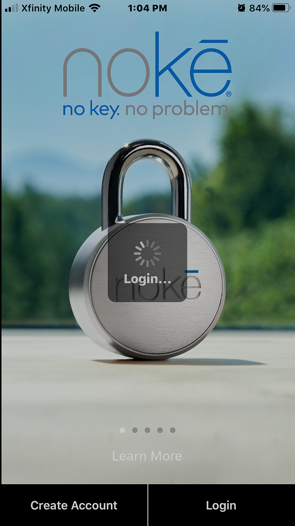

Install the app on your Bluetooth device. Start it up. You will need to give a valid email address for the account because they will send an email to you that you need to click to verify your email for the account to activate. No activate, no use the Noke.
Start the app.
Click the Create Account button
Follow the instructions to create and verify your account. You can read the Terms of Service, but other than requiring two oranges, some feta cheese and something about a blood sacrifice to Satan, I doubt there will be much out of the ordinary in there. :wink:
After verifying the account, log in. Be sure to click the "Remember Me" button unless you want to re-log in each time you open the app.
