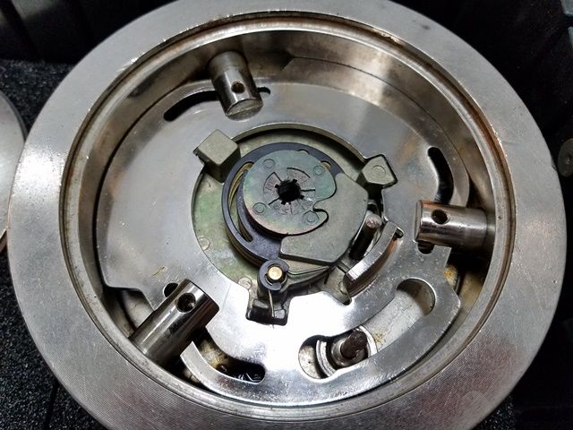

Postby BlueLock » 8 Mar 2017 18:56
Photo of the "before":
The brown material on the plates and underneath is really gummy.
Mods/Admin: I did not see any prohibition of double posts in the forum rules. If there is, please combine as needed. Thanks

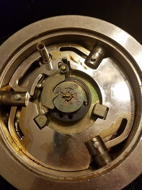

Postby BlueLock » 10 Mar 2017 15:03
Update: The pins are out. As most of you know, you cannot simply pull them out.
I made an adapter to attach a slide hammer to my Vise Grips:
All 3 came out with gentle persuasion. Ok, not quite so gentle. The trick was to firmly "tap" them out versus trying to use big whacks.
Pins out:
Ta daaa :)
Also, I contacted Amsec regarding the correct/proper/recommended lubrication. The definitive answer is: White lithium grease.
Thanks to all for your input and help!
