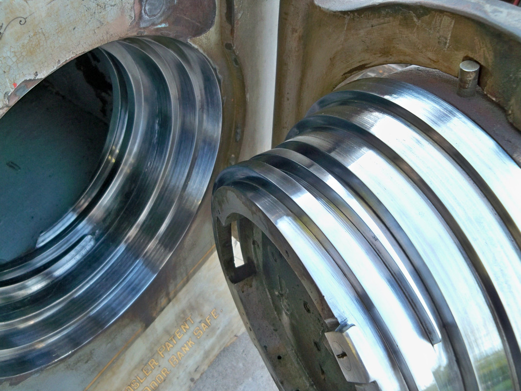

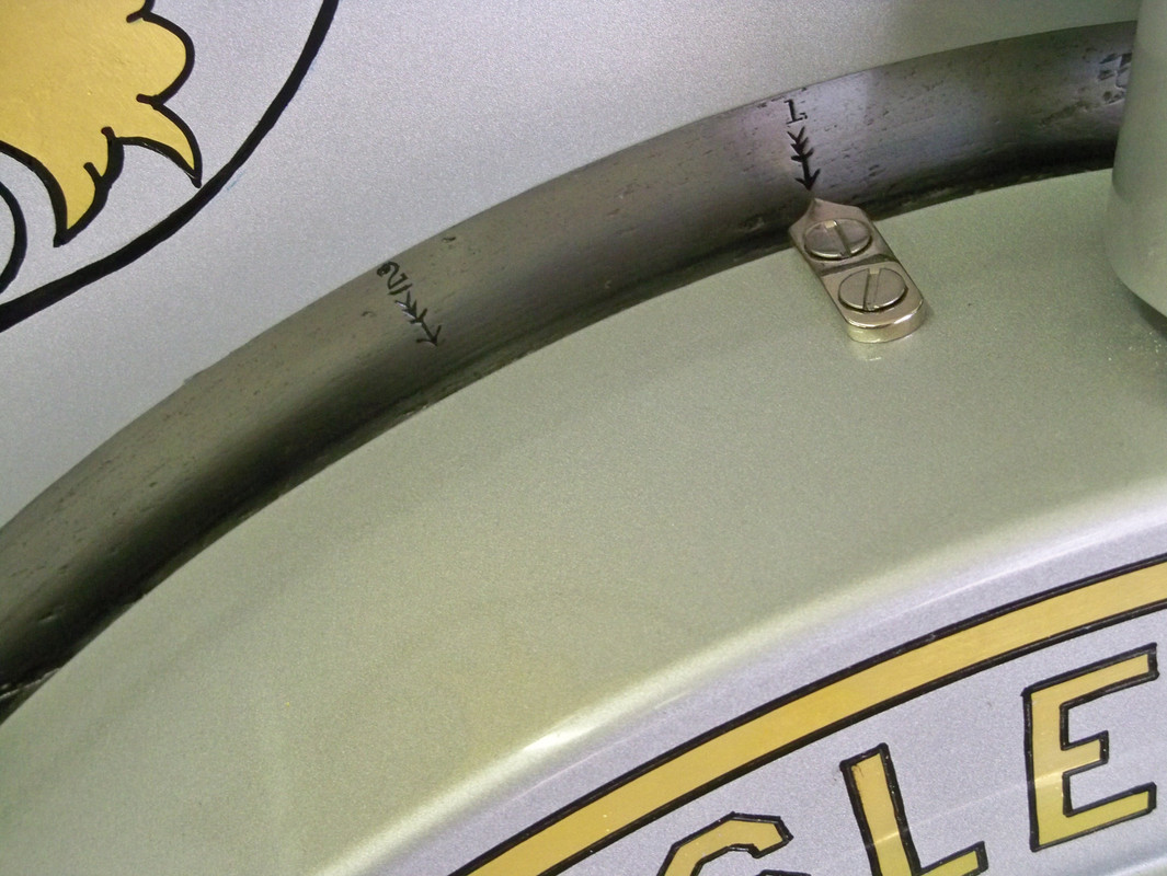

You can screw it in part way just don't seat it all the way in or the rust could jam it. I can't see it in any of the pictures but there is a lock piece that is toggled by the time lock that catches on a piece in the door jamb. It only will catch if spring pressure is forcing it out and the door is aligned to the fully closed position. I can't find a picture so I will take one later. There should be alignment marks on the door and the jamb. Just make sure, if yours is not missing, that it will not flop out. I forget off hand if it is at the top or the bottom when closed. If at the bottom gravity could be a problem if it flops out.

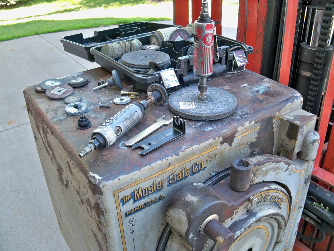

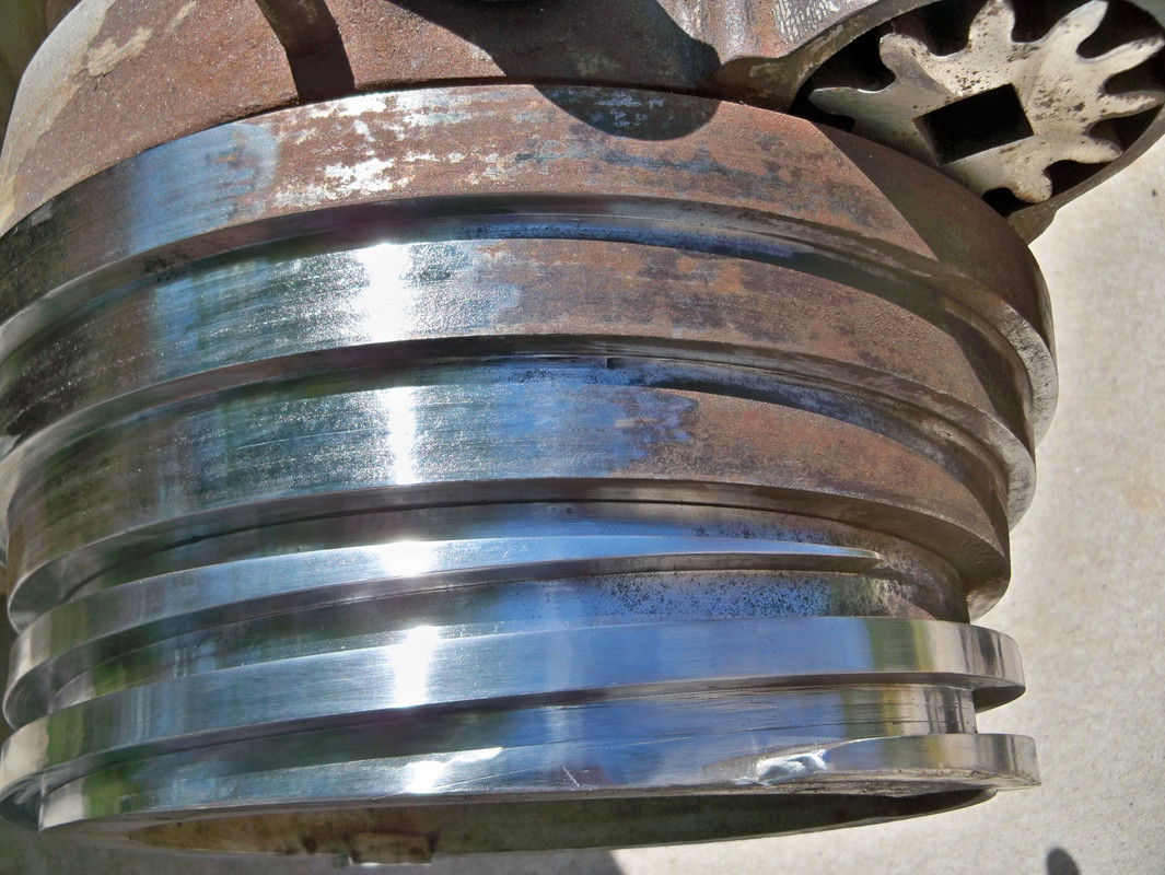

I found that the best way for cleaning and polishing the door and the jamb threads is to use 3M EXL wheels on a die grinder. They are expensive but are cost effective in the long run and do the job fast. Norton also makes a similar wheel. That will remove the rust quickly and lightly polish the metal. More than likely the threads will be steel but the stepped body of the door and the jamb will be laminated burglar plate. The body of the safe will be made of the burglar plate as well. It is easily identified as you can see the layers of iron and chrome steel laminated in each piece. The burglar plate was advertised as burglar proof, used in safes, vaults, and in the construction of jails and prisons. The pieces are stacked to create the stepped body of the door and the jamb. The mating surfaces of the door and the jamb should clean up nicely. Here are some pictures from of one of my Mosler projects.

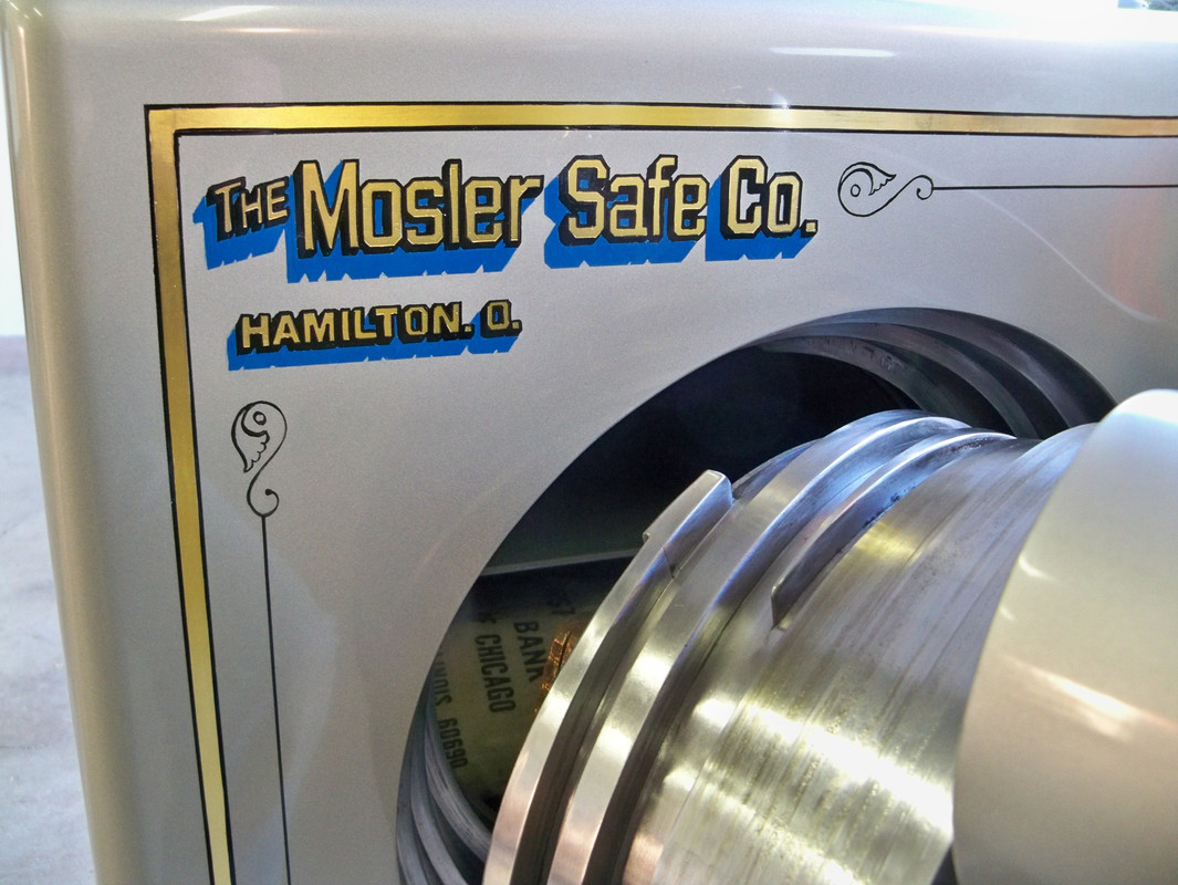

I just noticed the third picture shows the slot in the door where the latch fits. Yours may be different.
The one Mosler even has an indicator for door closed position.
