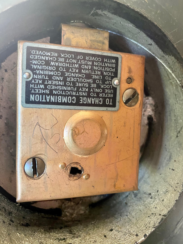

Could we have a photo with the inner door cover off so we can see the way the lock is mounted? Those types of photos, especially in color are getting harder to come by. If you can take one with the lock cover off as well, that would be fantastic!
Thank you,
I will be glad to do that as soon as I can.
BTW, where can I get a key that you use to change the combo? Are those generic or model/serial number specific?
Thank you,
Change keys come in different shapes and sizes and can sometimes be found on ebay. We would have to see the shape of the hole on the back cover of the combination lock case to narrow down which change key will fit.
Looking forward to your photos, thank you,

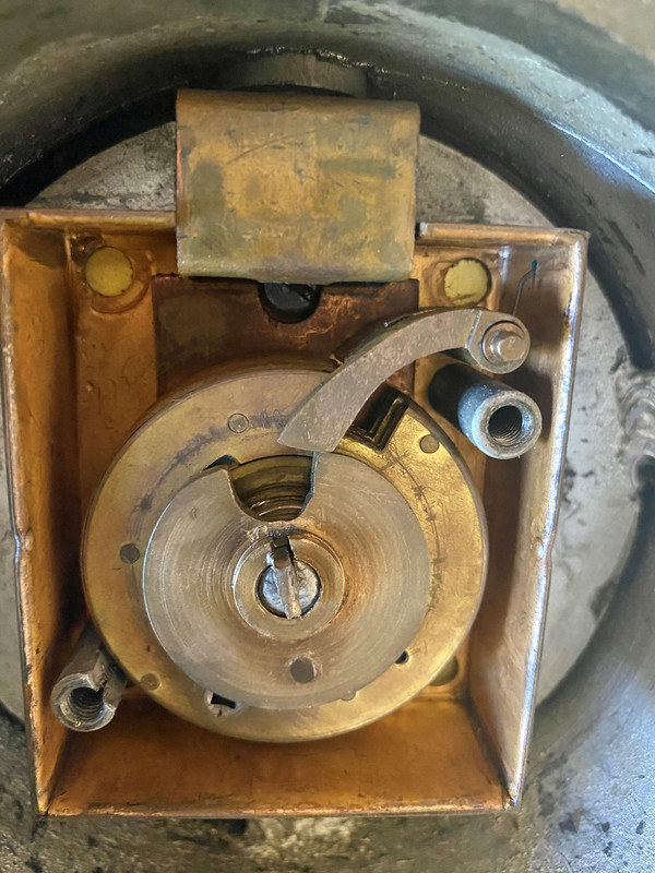

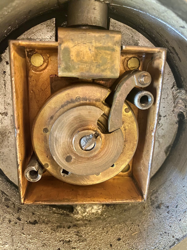

Here are some pictures of the back of the door and mechanism:
[image]Image[/image]

With the outer plate off and the lock bolt in the open postition
With the lock bolt in the lock position

Postby GWiens2001 » 9 Dec 2020 18:56
Simple, but robust and effective.

Lock looks to be in the Mosler KC-1 lineage.

L4R3L2 wrote:Lock looks to be in the Mosler KC-1 lineage.
That's good to know. Thanks!!

Anyone have the HPC book kicking around that tells which change key to use on this lock?
Posts: 11344
Re: Mosler with no Combination
Postby MartinHewitt » 10 Dec 2020 9:47
01091 (two prongs) or 01096 (one prong), whatever that means.

Postby Squelchtone » 10 Dec 2020 10:50
[quote="MartinHewitt"]01091 (two prongs) or 01096 (one prong), whatever that means.[/quote
Perhaps these are prongs?
Posts: 11344
Postby MartinHewitt » 10 Dec 2020 11:08
Yes, the tiny drawings look like that key.
