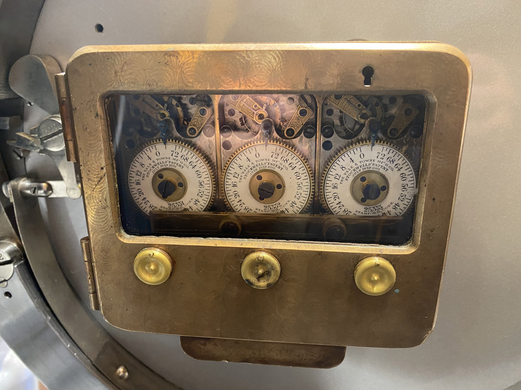

Postby Brady737 » 12 Jan 2021 9:55
New development. I have acquired a later version of this Mosler. I am hoping that the mechanism behind the plate will provide a template for the other. What type of steel are these parts made of. I have a great machinist that I think can recreate the parts if I give him an example. The 3L in this safe is awesome and I am very happy to have a complete one. ImageImageImage

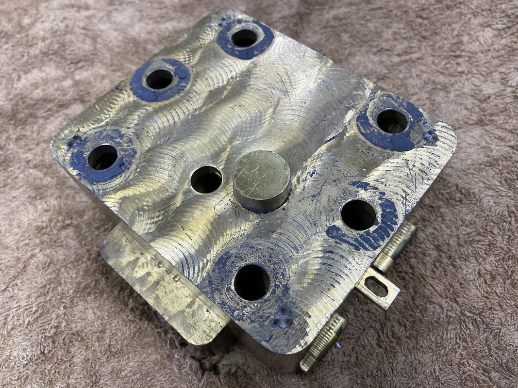

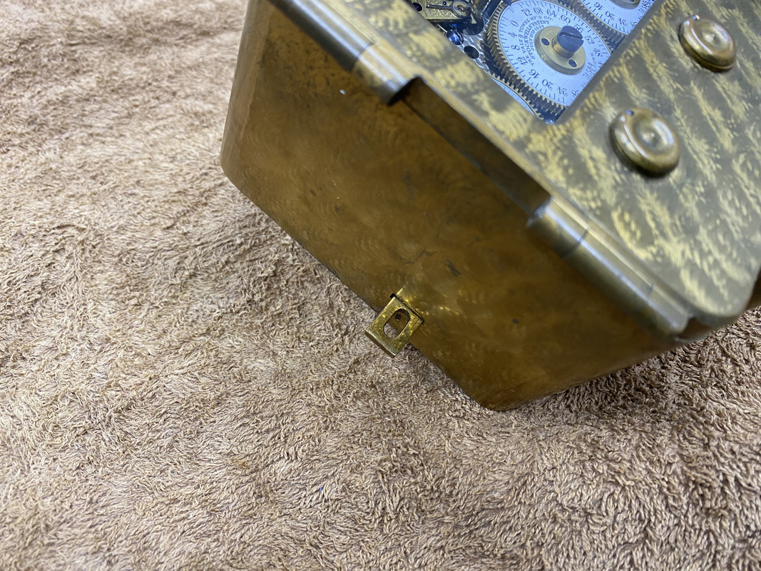

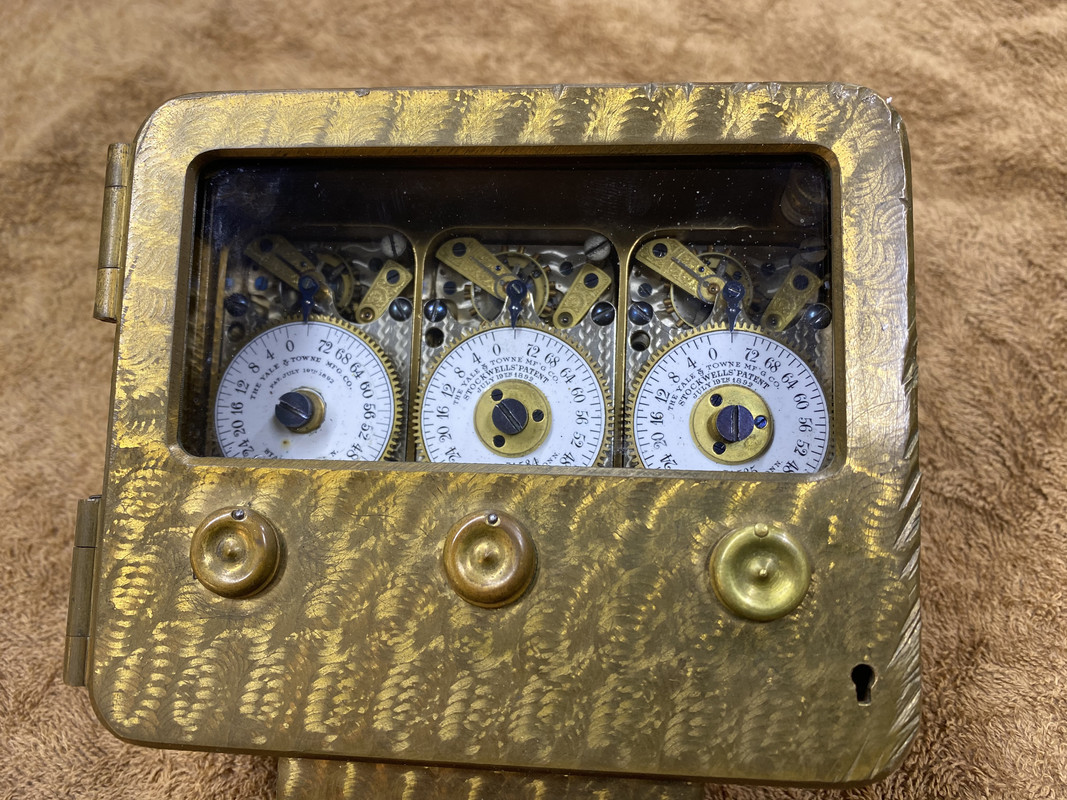

Postby Brady737 » 11 Jun 2021 7:32
Another step....picked up the correct Yale 3L time lock. Thanks to Mark (marksonli9) for taking a very beat up piece and restoring! Incredible work! The door was bent, glasswork broke, finish was sanded in places and the time pieces had not been cleaned in decades. Here are the before and after pics. Its ready to go. Next couple of steps are disassemble the safe and media blast, prime and have the linkages reproduced. Slow but sure.
Image Image

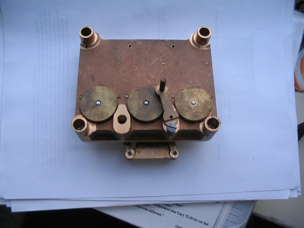

Postby Brady737 » 26 Jan 2022 18:57
As we continue down the road of finding parts. I have found donor parts including another Yale 3L time clock in Nickel. I am in search of an example picture of this older screw safe. I have an example of a 1910ish with a different mechanism. Please take a look a the two different layouts. The example pic is quite a bit newer and has a different setup, please take a look........Image, Image
