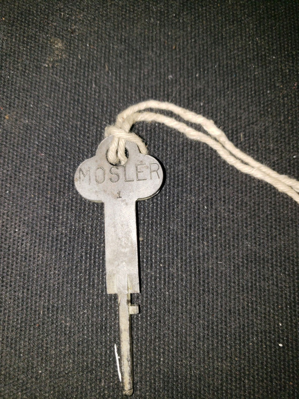

Postby matchframe » 18 Dec 2020 7:35
Remember that my safe was inside another safe. The guy who bought that safe in an auction took the lug door safe out and I bought the lug door safe. He sent me a picture of the change key that is for his safe which should also work for mine since they were actually two safes in one. Here the change key picture he sent me.
So, I just need to match this key to one on that site where I can buy a change key, correct?
[image]Image[/image]

Postby L4R3L2 » 18 Dec 2020 22:32
matchframe wrote:Are you saying that when I get a change key, I should dial the numbers CW, then CCW, then CW then CCW to zero?
Probably. But, I wouldn't really know until you try dialing the sequence as I outlined, and/or maybe see how many large diameter wheels are in your lock.
That change key looks a bit longer than my SLC-32 key. But, the number 1 stamped on it leads me to assume it is Mosler's key for their KCB-1 lock, which is the same as the SLC-32 key. Otherwise, it's also possible that change key may be for the lock in the main safe, which may not necessarily be the same as the one in your inner safe. Worth a try, though.
