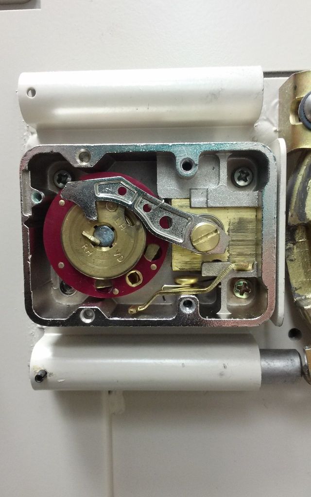

I just wanted to show a lock I was called to repair. There are a lot of untrained and incompetent people portraying themselves as locksmiths/safemen.
I was called to a branch bank in a store. Their complaint was that they could close the vault door, spin the dial and then still open the vault.
The photo is of the lock immediately as I took off the back cover. The bolt screw was so loose that the lever had slipped down outside of the drive cam and would not throw the bolt. All screws in the lock case were loose. And the one-half of a spline key was twisted nearly out of the spindle.
Im just glad this didnt happen while locked.
Raymond

:shock: :shock:
You'd think that a bank would want at least someone who is a member of SAVTA, or some such organization. Something that shows a minimum level of competence.
It was a little fun looking at the pictures, figuring out all the things wrong. Am a bit surprised that the back cover did not keep the lever from moving out that far.
