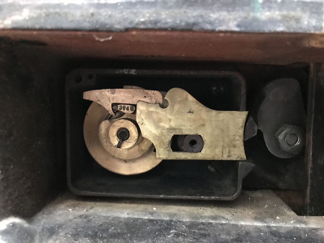

I believe I have the same safe sitting back in the archives. 24" wide, 22" deep, and 34" tall including the wheels. I have the same info and patent date on the dial. My serial number is quite a bit older than yours at 26781. The serial number is also stamped on the top inner edge of the door at the center. I do believe mine is older as the dial and bolt work handle are not plated.
Yes, it is heavy. That is because it is a thick wall fire safe. The door is 5.5 inches thick. There is quite a "brick" behind the lock for insulation. These doors fit very tight and have the "steps" to reduce fire and smoke intrusion.

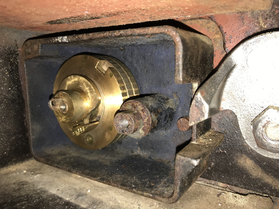

Here is the lock. I'm sure others can identify it for you. Three wheels with notches to make manipulating more of a challenge.

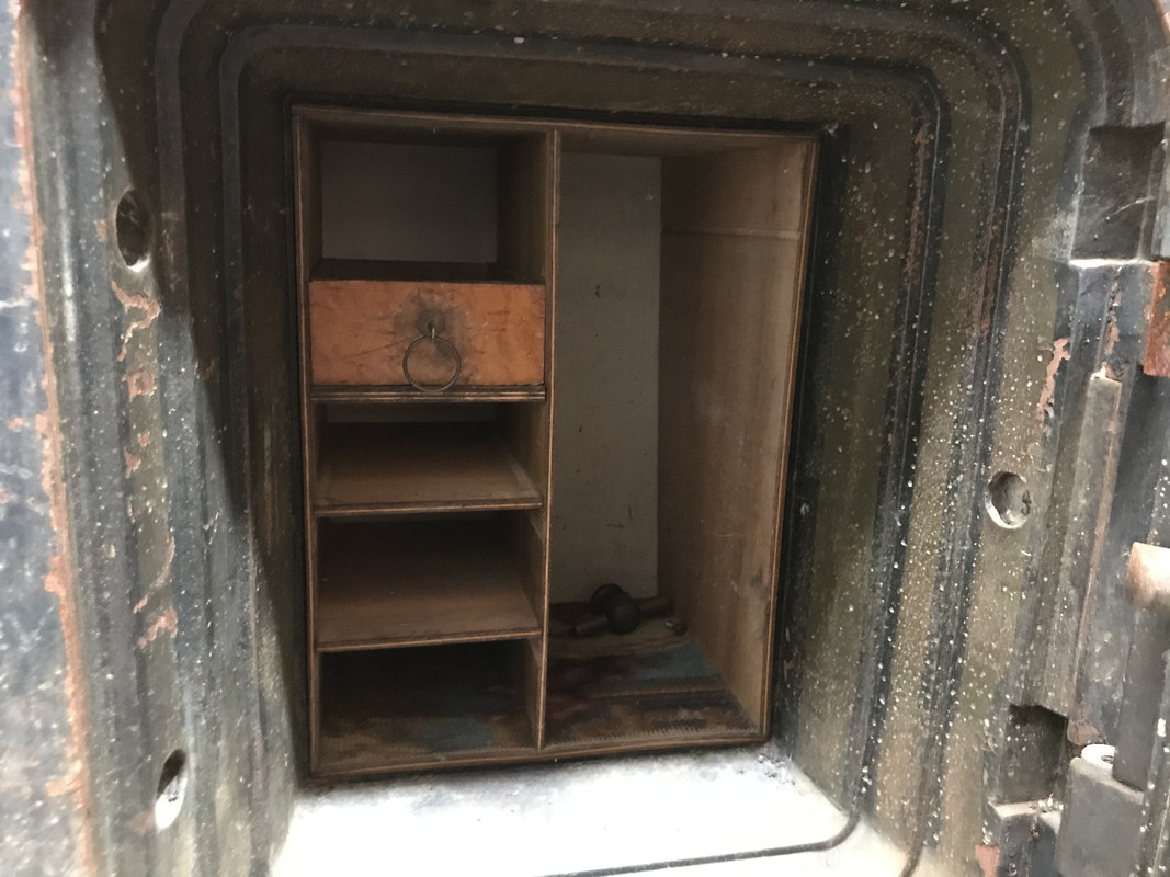

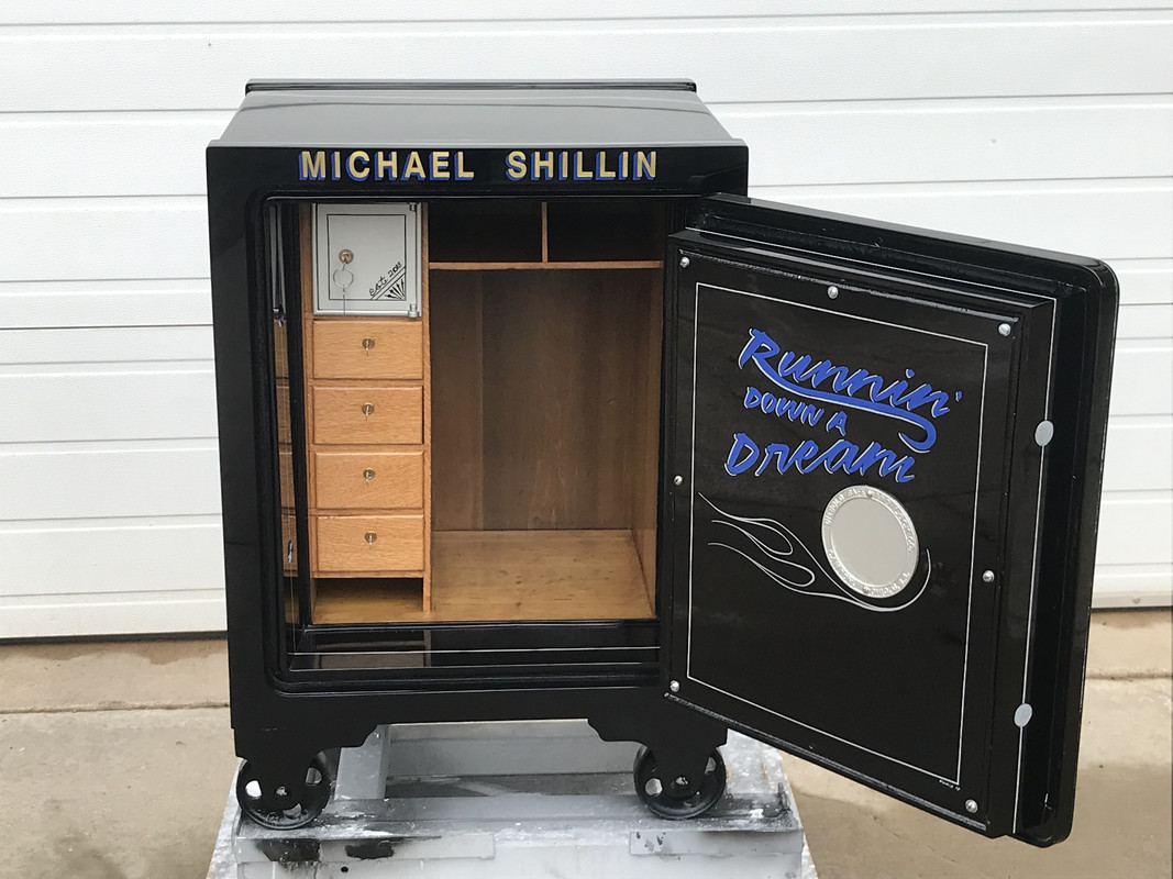

The inside is quite small due to the thick walls that are filled with mortar. There is supposed to be a metal compartment in the upper left corner. I robbed it for another Diebold thin wall security safe from the same era that I recently reworked. The drawer is supposed to be in the next hole down. A picture of each for comparison of the wall thickness differences.

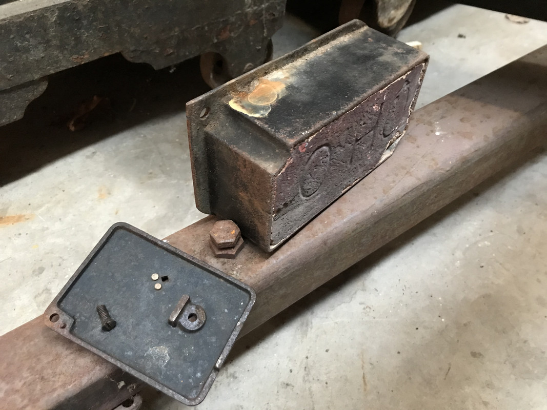

Postby MartinHewitt » 21 Apr 2020 14:55
Nice! What is this brick? Is that the fire insulation lock cover?
