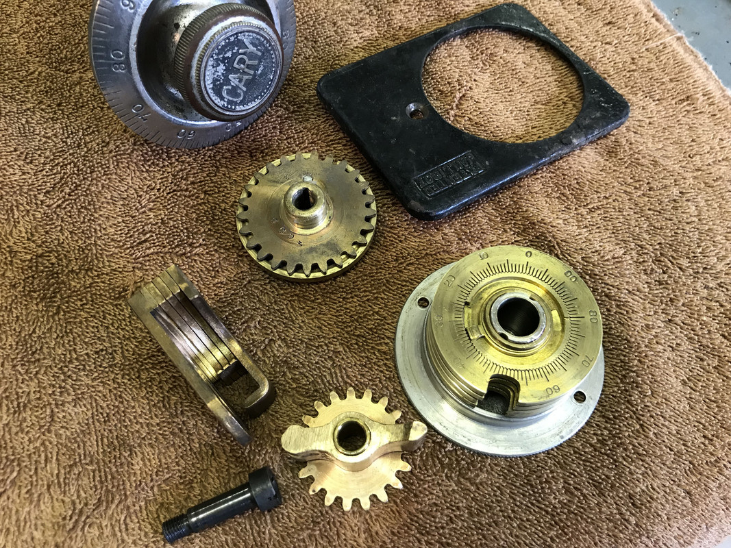

For those who are curious, here are pictures of the Y6 internal parts and of the wheel pack. This one being a 4 wheel, did they also come with 3?

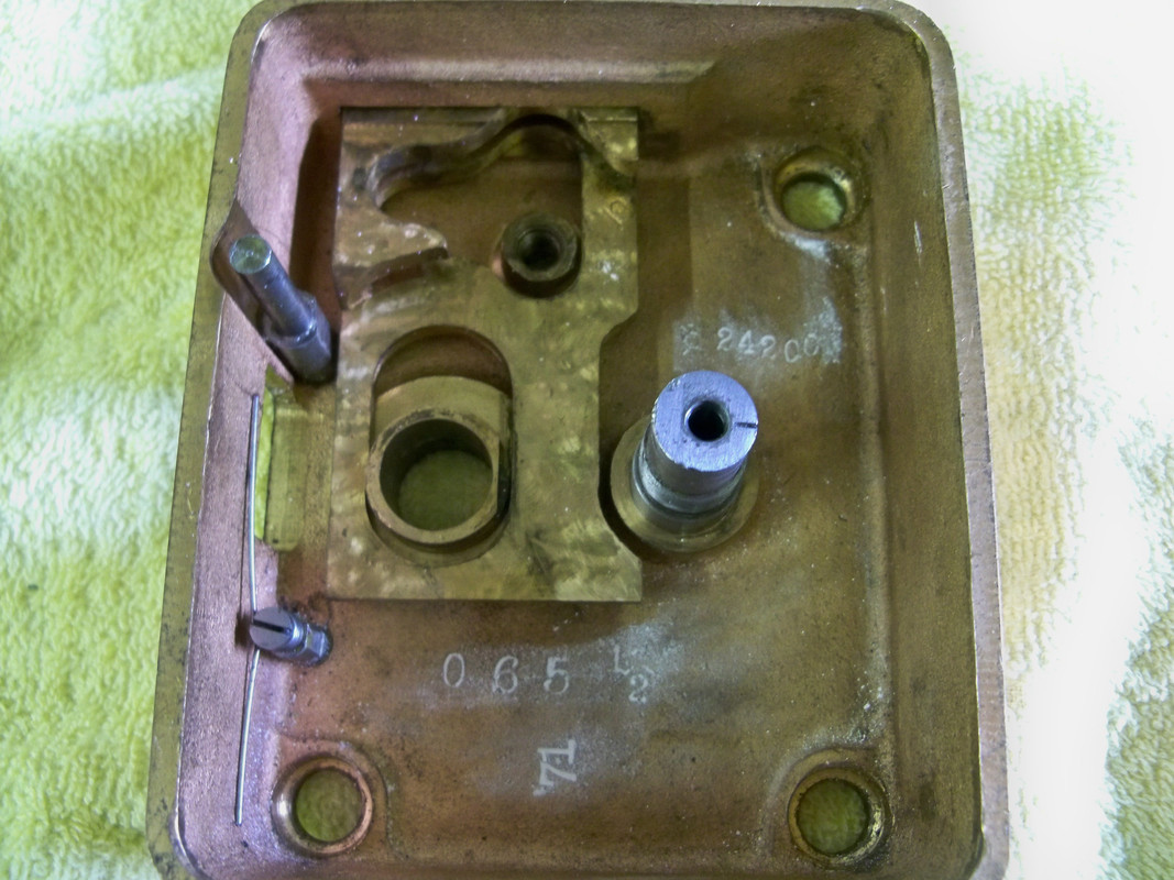

Lol Martin, I thought I recognized that sloppy dialing. It is actually a Yale 065 1/2 which I believe to be a very uncommon model. That is from the National Safe and Lock Co. Manganese Money Chest I redid a couple years ago. My favorite safe.
