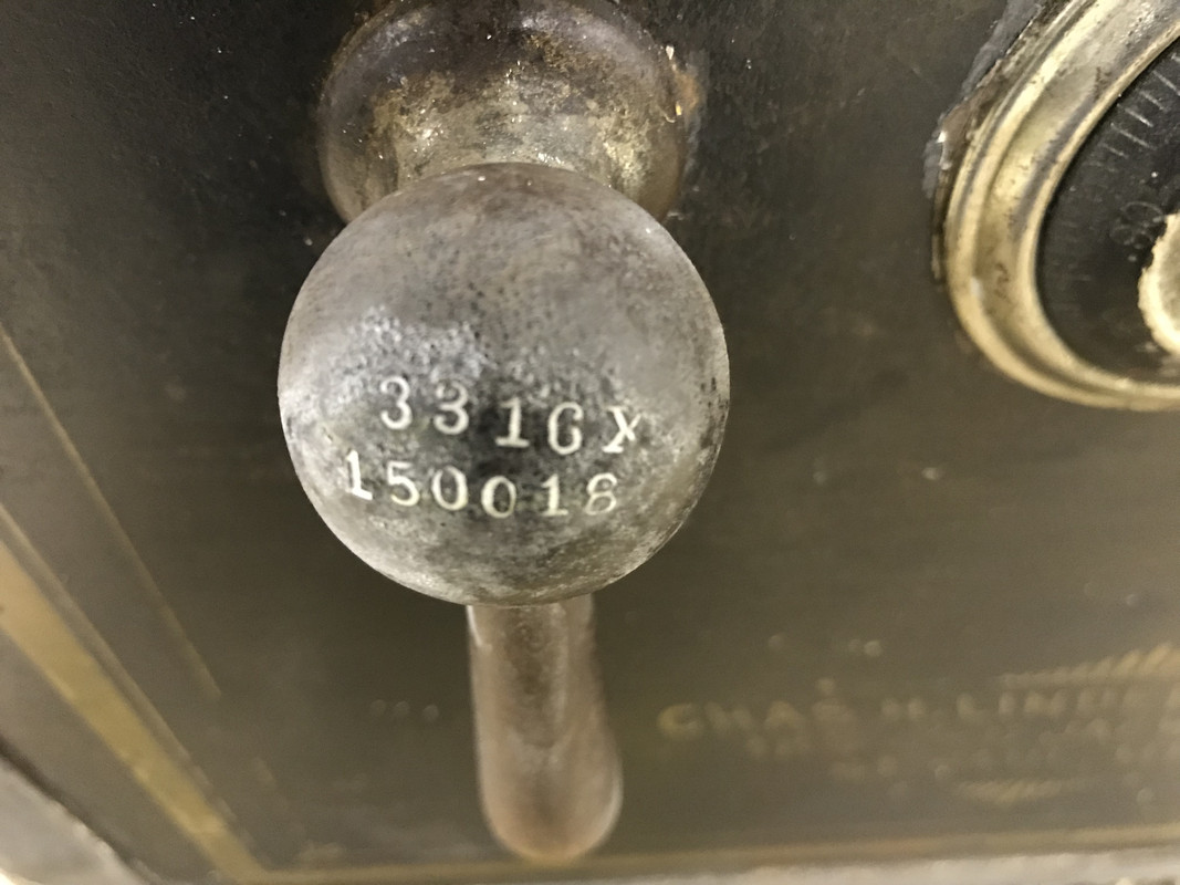

Hello: Hoping someone might be able to give me a ball-park age on a safe I am attempting to restore. I assume photos would be easier than me trying to explain things via text so I'll attempt to post them below.
In the process of sanding the exterior I have come across a set of numbers that appear twice. Those numbers are 160638, which appears on the top of the top hinge. This same number appears on the handle/lever with the addition of 3316X.
I am assuming that this might be the date of assembly 16/06/38 or June 16, 1938, a Thursday... or not.

If you could show us a good in focus close up photo of the combination dial next to the entire handle, as well as the entire front of the safe with the door shut, that helps a lot more to ID the decade it was made in. a close up of the lock inside the door would be good to see as well (it looks like Diebold's K Lock) as sometimes certain locks were used for a certain period of time and then other locks were installed on similar safe bodies (think of it like buying a car, but the car radio is made by Sony or Kenwood, a lot of lock makers would use someone else's locks on their safe bodies.)
I am 99% sure the the serial number does not decode the the 1938 date you mentioned. I believe this safe to be much older.

Those are great shots! thank you! It's gonna look great when you are done painting!
I don't have an exact date for you, someone else probably will, but that is a thin walled safe with K lock. Probably 1890-1915 plus or minus.

Postby 00247 » 20 Nov 2020 16:39
Squelchy nailed it. I had one of that model although mine did not have the inner door option. You can read about it at this link. Unfortunately, some of the pictures were lost in the thread but most are still there.
http://keypicking.com/viewtopic.php?f=100&t=12899
They do make an attractive safe when restored. By the way, the lock and handle remove easily so you don't have to work around them. My numbers were 3316X, 150018

Postby Sir Ken » 20 Nov 2020 17:04
00247 wrote:By the way, the lock and handle remove easily so you don't have to work around them. My numbers were 3316X, 150018
So, the 3316X is a model number... since your number matches mine, then my 160638 is the serial?

Postby 00247 » 20 Nov 2020 17:20
Yes, it is the serial number.
Remove the cover on the lock, the wheel pack is mounted to the cover. Inside you will see the spline key, remove that and the dial will spin out of the drive wheel and can be removed exposing the screws that hold the dial ring to the door. Take the nut off of the handle shaft which holds the bell crank and the handle will come off. If the bell crank is stuck leave the nut on but loose and tap with a hammer on the nut to loosen. That protects the threads. Look through that link I provided it will show the innards.

Ok, Facebook group to the rescue. According to Bobby Overbey Sr. the date for this safe would be 1919.
