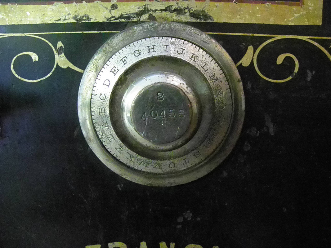

And then there is the McNeale and Urban safes with their alphabet dials. My uncle has one which is set to L,O,C,K.
Photo from this site.

Postby Kenneth_V » 23 Jan 2021 14:32
00247 wrote:And then there is the McNeale and Urban safes with their alphabet dials. My uncle has one which is set to L,O,C,K.
Oh I need one of these!!!!!
