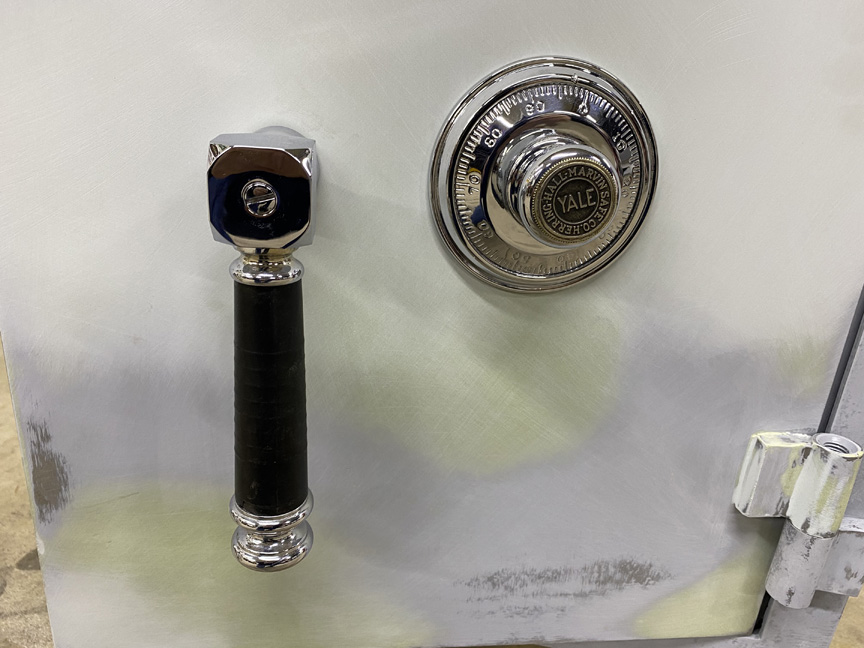

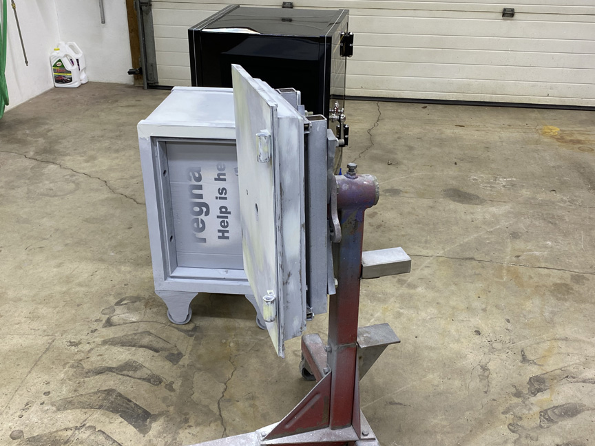

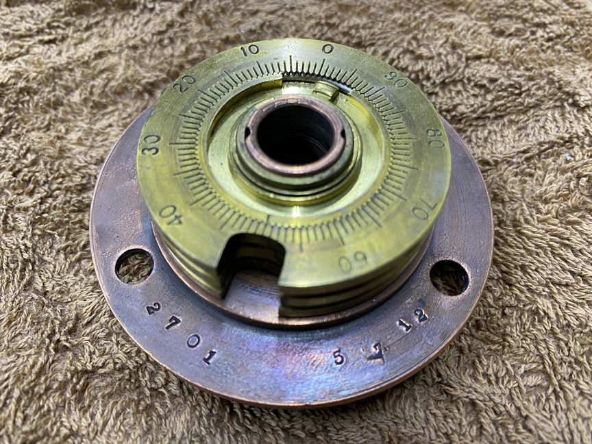

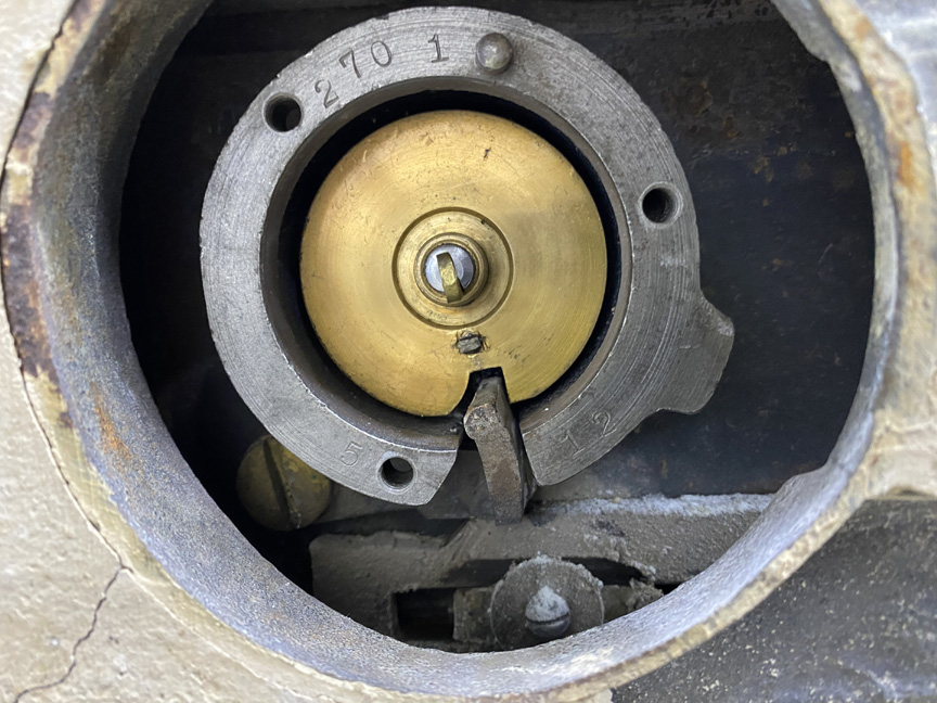

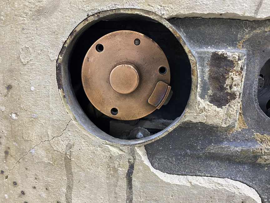

I have a very similar HHM safe. The construction is slightly different with yours having the angle iron framework on all corners where as mine only has the front and rear framework. The wheel assemblies are also slightly different. I will bet they have the same lock set up although my handle is different. The dials look identical. The handle is off in this picture.
Despite mine being torn apart for refinishing, I reassembled it to show the lock. It has been on the back burner for a while stuck in the early bodywork stage. Maybe this will get the project going again. lol
Here is the front of the door back together. Sporting a shiny new finish.
With the door rear cover removed here is the lock.
With the wheel pack removed you can see the drive cam. In this lock it is nearest to the dial. When the drive cam gate is in position for the fence the dial is at 0. Note the ramp on the door bolt linkage that moves the gravity fence up into the gates. Mine dials L-R-L-R to 0.
Here is the wheel pack which is similar to many other Yale locks. It has movable flys and friction washers. Note the wide gates.
Here it is in action.

Thanks so much 00247, this is fantastic info, great pics! The video didn't play for me, maybe it's private?
The mechanics seem demystified, which is important for me being very analytical. :oops:
