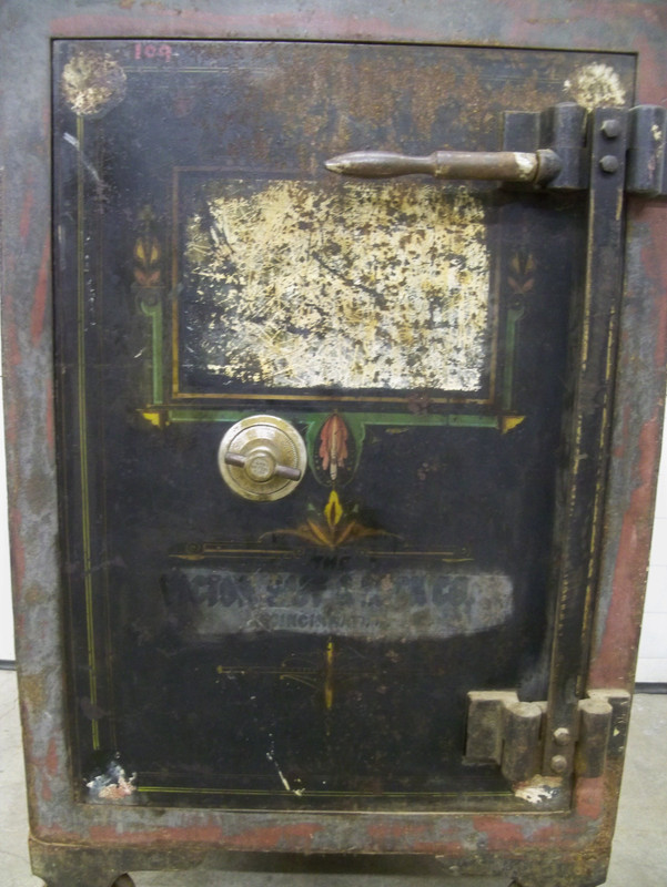

I would say Squelchy is correct. One thing you can try before restoring it: Gently clean it with a soft cloth and mild cleaner like dishwash soap and water. Be careful around any lettering or artwork. These old safes have a coat of varnish over everything and is usually crazed and sometimes will rub off. When dry take a soft cloth (micro fiber is good) and dip it in a bit of satin or semi gloss varnish and rub a light coat over the old finish. It will bring out the colors of the lettering, paint, and artwork. Some will use mineral oil but I prefer varnish as it will add some protection. Now this won't help the unfortunate worn off paint and picture around the dial on your safe but it will look pretty good when done. The original artwork is good enough to maybe leave as is.
Notice how much it improved this faded out old Victor safe. It was in really poor condition. I didn't go over the lettering as it is very fragile. It is now good enough to trace a pattern of the artwork. That is IF I ever get to this one. I should as this No. 6 Victor has the uncommon optional ($10) double knuckle crane hinge and inside chest with the same hinge.
