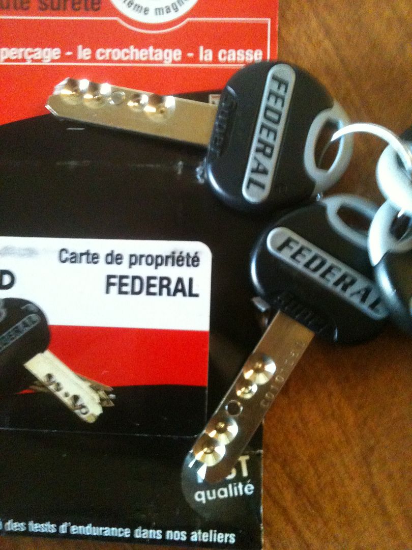

Postby GWiens2001 » 16 Jan 2014 18:12
huxleypig wrote:
l0ckcr4ck3r wrote:The Avocet ABS is a cool lock. I picked one only the other week. It has MTL-like pin-in-pins and a 'magnetic' pin (the pin is just metal, any old magnet will work on it).
Sounds like a Thirard Federal...
Posts: 7661
Re: Medeco m3 2013
Postby ARF-GEF » 17 Jan 2014 4:57
Rightly so, I suspect it's the same lock with different name.
