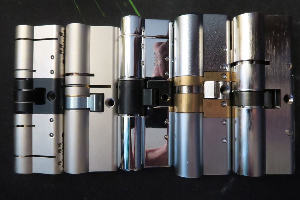

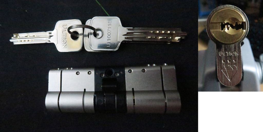

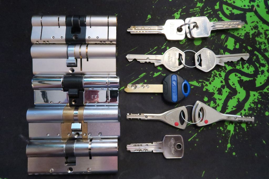

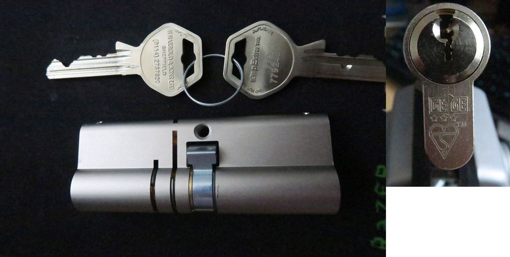

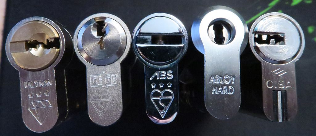

Postby LocksportSouth » 13 Jan 2016 9:45
And a thanks to the (available) contestants, in what miiiight be 50% interesting lock research and 50% lock porn :mrgreen:
Left to Right: Brisant Ultion, Kaba (GeGe) pExtra Guard, Avocet ABS, Abloy Protec2, Cisa Astral S:
Same order, from the side:
Same order again, now with keys:
Boxed up:
Some observations I've had, laying these all out side by side (and to prevent this turning into a pure lock post):
* Odd how the Avocet ABS is the only one with a wide open keyway. Not sure why they went that route, but it did three things: A) make the key extremely resilient to damage, B) Make inserting the key a doddle, and C) give mountains of room for picks...
* The Ultion is NOT BS marked, but has 3 stars and the diamond sold secure. I *THINK* that Sold secure is at least equivalent of the British Standards ratings, but I know that the cylinder isn't BS rated if it doesn't have the kitemark, although I don't know if the diamond standard mark supersedes the kitemark or is simply a different thing. Will have to research this more.
* Interesting the different anti-snap measures the different manufacturers all take. The Brisant and Kaba go down the "lots of break off points" route, and I know at least the Brisant and the Avocet have locking cams (cannot be actuated by a screwdriver even if the cylinder snaps off all the way to the cam. The Abloy of course going down the anti-snap route (with a hardened bar) rather than the snap-secure route - not sure how the Abloy fairs against snapping though and I'm not crazy enough to test mine :D. The Cisa.... Eh, they tried :D.
* The Avocet key kinda reminds me of a Mul-T-Lock, with it's pin-in-pin dimple but few actual pins if you count the individual stacks. The Ultion has a kinda disappointing looking standard dimple design tbh but it does looks more secure than the Cisa overall.
* The Brisant is the only one to extend their anti-snap protection, and thus full BS (or Diamond) rating to both sides. I wonder if this will catch on?
Wish I had a Mul-t-lock to compare with these now :).
