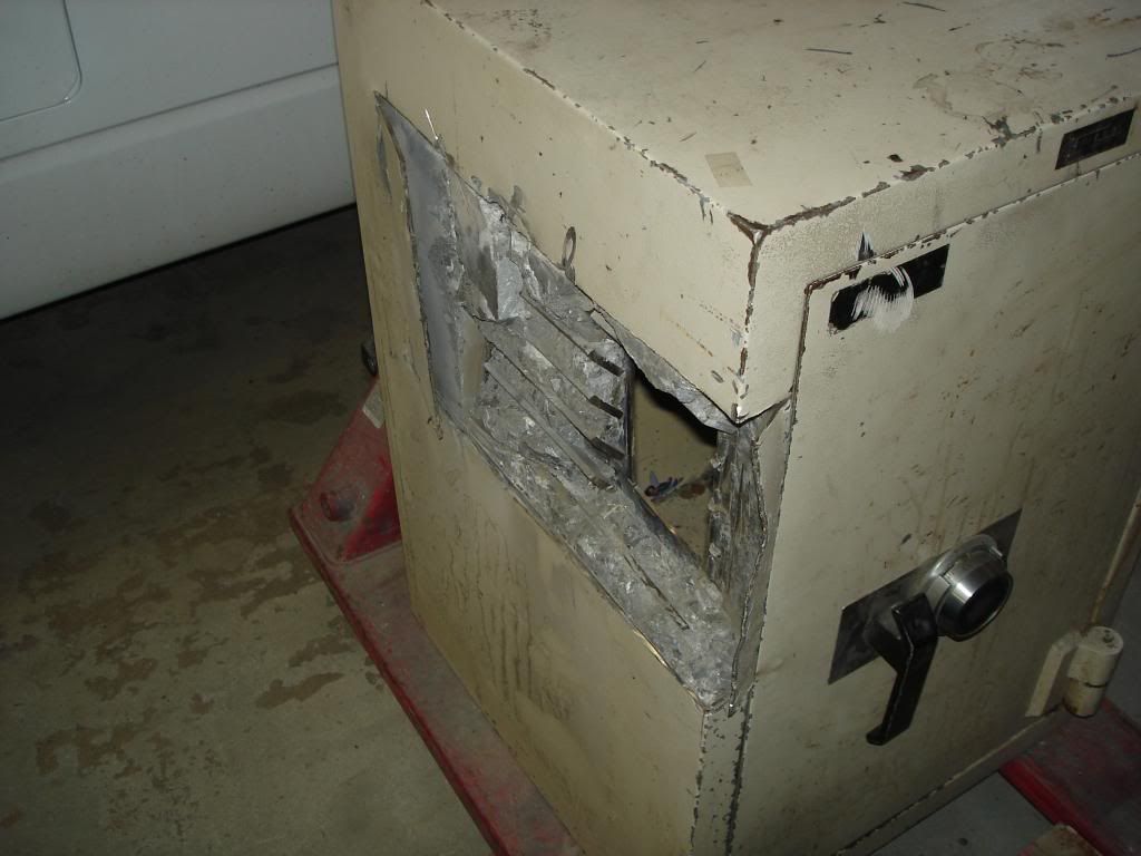

I don't know of any lock or chain that can resist attacks from a Zip disc.
Some materials like carbides, are extremely hard to grind, but will shatter if struck with a hammer.
There are no materials that will be "everything proof". As far as I'm concerned, locks are already made from the best combination of metals to server their intended purposes.
The puck lock with it's proper hasp is probably the best against grinding due to it's bulk. It'd be the most time consuming effort. Time is a thieve's enemy, but if given enough time, and enough Zip Cut discs, a die grinder or angle grinder will cut just about anything.
